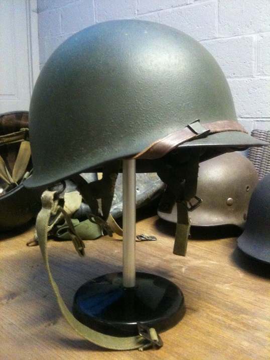

And here are some pictures of the latest helmet that got this treatment. Unfortunately, I do not have 'before' pictures. This perticular helmet had 2 layers of postwar repaint. Top coat was military green, and the 2nd layer was a shade of sky blue.
The finished project;

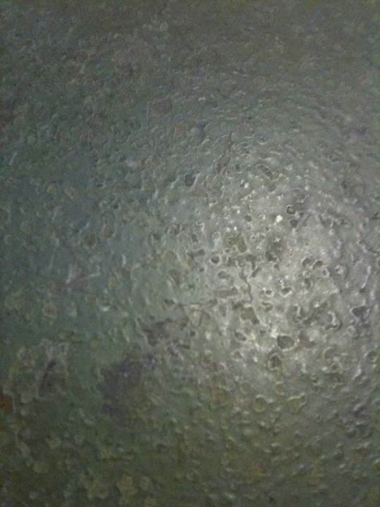

In this picture you can see the remaining 1% of non original paint. The blue paint was not so forgiving, and takes some work to remove. I stopped here, as to not damage the original cork texture and paint.

This is a shot of the texture and original paint, after my treatment. This is in fact the end result after removing 2 layers of paint with this technique.
I hope you like it.
