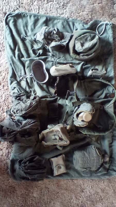

Vanderbilt Posted October 6, 2021 #409 Posted October 6, 2021 ......thought this might be of interest? Some extra web gear, canteen cup, cold weather cap and mask and a pile of those cloth bandages we used for everything from carriers to head rags and everything else in between. This was stuff that others lost or discarded and came home in my box from Germany.
