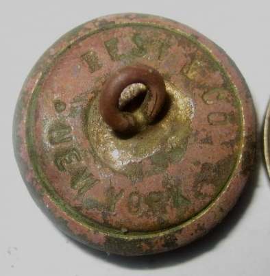

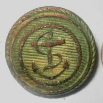

dag Posted June 17, 2015 Author #53 Posted June 17, 2015 Backmark is "*Best & Co.*/New York", listed at 60 W. 23rd St. NYC. "Made Uniforms in WWI & II" per American Military Button Makers and Dealers; Their Backmarks & Dates, by William F. McGuinn and Bruce S. Bazelon. This reference also lists that this manufacturer made the "NA-131A type but smaller circle". This refers to the numbering system per Record Of American Uniform And Historical Buttons, by Alphaeus H. Albert, in which lists this button was used by US Navy Chief Petty Officers. I have also seen similar buttons listed as Merchant Marine or even non-military/maritime.

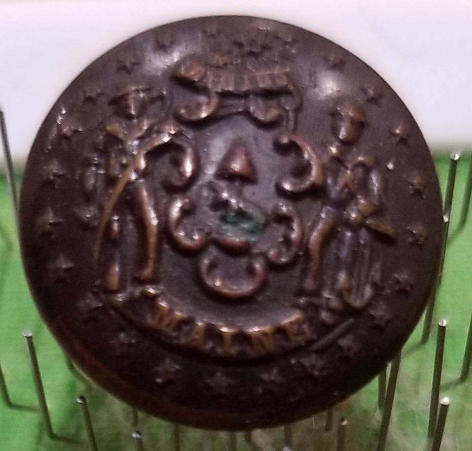

cagedfalcon Posted May 7, 2019 #68 Posted May 7, 2019 This seems the place to post buttons for ID. Picked this up a week ago in a group of buttons. It is 15.5mm, 3 piece. Top banner? bottom banner says Maine, 2 sailors, one with anchor other with? Any idea? Thank you Sent from my SM-G950U using Tapatalk
aznation Posted May 7, 2019 #69 Posted May 7, 2019 This seems the place to post buttons for ID. Picked this up a week ago in a group of buttons. It is 15.5mm, 3 piece. Top banner? bottom banner says Maine, 2 sailors, one with anchor other with? From what I've been able to determine, it's a State of Maine, state seal civil war coat button. The Maine state seal was adopted in 1820 and has gone through several revisions. The seal is comprised of a farmer and a sailor representing Maine’s sea industry with the motto “DIRIGO” (“I lead” or “I direct”), which the word "Dirigo" is at the top of your button.
cagedfalcon Posted May 7, 2019 #70 Posted May 7, 2019 From what I've been able to determine, it's a State of Maine, state seal civil war coat button. The Maine state seal was adopted in 1820 and has gone through several revisions. The seal is comprised of a farmer and a sailor representing Maine’s sea industry with the motto “DIRIGO” (“I lead” or “I direct”), which the word "Dirigo" is at the top of your button. Thanks AZNation, you are a well of knowledge Sent from my SM-G950U using Tapatalk

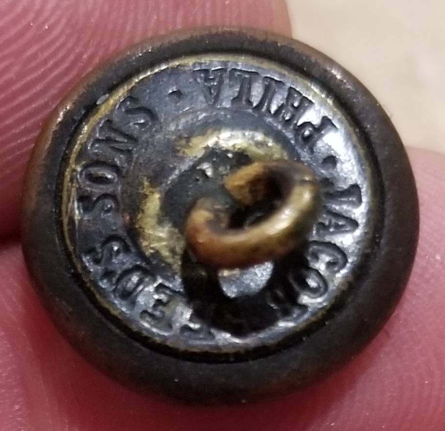

dag Posted May 8, 2019 Author #71 Posted May 8, 2019 I echo aznation's assessment that this is a button from Maine. Probably worn late 1800's/early 1900's. State Seal buttons were popular for state militia units (and sometimes state officials) prior to the standardization of US Army buttons in 1902. The backmark is Jacob Reed's Sons / Phila, maker of many such State Seal buttons for several states. dag

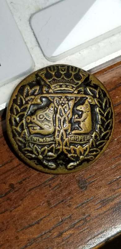

Guest Ravenwolven Posted December 29, 2020 #73 Posted December 29, 2020 Hi. I could really use some help identifying a button I found amongst my grandpa's hardware collection. It's about the size of a penny, 2cm across, 5mm thick, 2 piece, extremely light weight, no back stamp. I'm having trouble making out the text, but it appears the banner on the left reads NFORTINSDAN and the banner on the right reads FANSPEUR. At the top is a crown with 5points. In the center are 2 animals divided by laurel. The one on the left resembles a bat's head the one on the right resembles a koala. There is a banner beneath each animal and laurel branches on both sides surrounding the design from bottom to crown. My grandpa was in WW2 in Australia and Paupaua New Guinea. My mom thinks it might be his father's WW1 uniform button. He was in France, but was an American. Please help if you can
LadyofDoune Posted December 30, 2020 #74 Posted December 30, 2020 The button shown is a fashion button copy of a British military button. You can tell by the indistinct artwork, the shank, the lack of a backmark, and the general way it is made.
mds308 Posted December 30, 2020 #75 Posted December 30, 2020 According to the 'American Military Button Makers And Dealers; Their Backmarks & Dates' book, all Jacob Reed buttons are post civil war. If you don't have this book, I highly recommend it. This book goes hand in hand with the Albert's Button Book.
