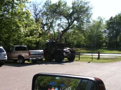

Actually I just saw a 1960s British armored vehicle driving on the road today. I made my mom follow him and he stopped in a park and I. Got to climb on it and look around. He said he dosnt need a license plate because they use the military one painted on it. He also said all the police know him half of them have ride in it. It had 2 30 cal machine guns and I'm guessing a 40mm cannon.
