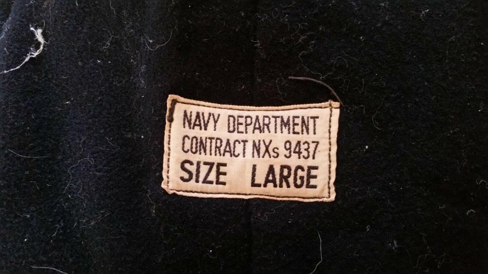

subsystem4 Posted May 13, 2018 Share #61 Posted May 13, 2018 How about this: Navy Department NAF 1169-2 Contract NXs 1404 Link to comment Share on other sites More sharing options...
dustin Posted May 17, 2018 Author Share #62 Posted May 17, 2018 The cold weather bibs you have are an early piece meaning pre-war under Naval Aircraft Factory drawing. What you are not seeing in the contract prefix is the "A" for Aeronautic. So read it as NXSA-1404. what you have is something about 1940-41 Link to comment Share on other sites More sharing options...

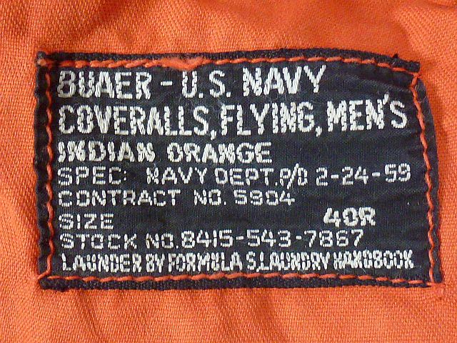

Will Posted October 31, 2018 Share #63 Posted October 31, 2018 If anyone has any thoughts on the dating of these two Navy flight suits I would be grateful! I assume that the tag in the orange suit gives us a "Purchase Order" date in 1959, which is, I suppose, a way of dating the suit as post-1959. But I cannot figure out anything more specific, nor can I come up with any idea of a date for the khaki Navy flight suit. Thanks, gentlemen! Link to comment Share on other sites More sharing options...

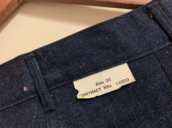

tthen Posted March 22, 2020 Share #72 Posted March 22, 2020 Ok so I know this is an old thread but I refer to it often. I found what I believe to be a WW2 or maybe pre contract number. Can anyone shed some light on this. Thanks Link to comment Share on other sites More sharing options...
tthen Posted March 22, 2020 Share #73 Posted March 22, 2020 1 Link to comment Share on other sites More sharing options...
tthen Posted March 22, 2020 Share #74 Posted March 22, 2020 Can't find anything on NXs Link to comment Share on other sites More sharing options...
