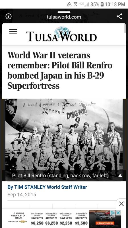

Mensagem: "This is the only other photo I've found of the C-1 vest in use. It is from the September 1945 issue of the AAF publication "Impact". The entire crew appears to be wearing the vests. The caption says they are on Guam, about to take off for a raid on Japan".

Yes and No,
Five hundred were sent to the ETO for service testing in the spring of 1944. None of the actual production ones of the contract types were sent to the ETO. All went to the PTO or West Coast stations for embarkation to the PTO.
