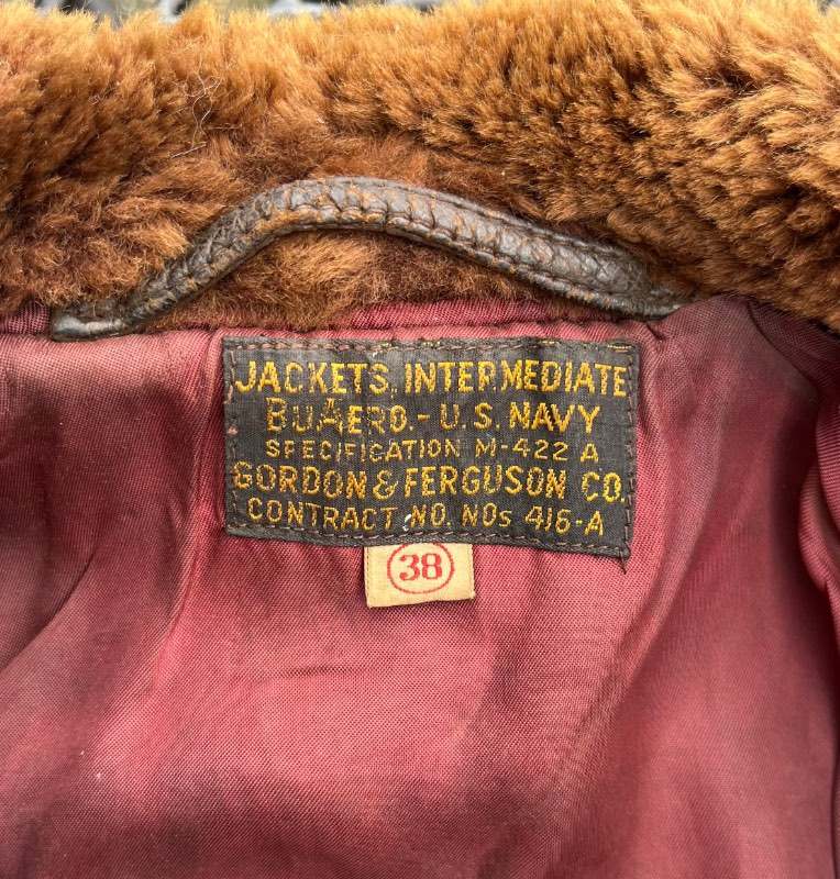

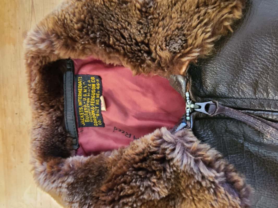

This is an M-422A I recently acquired.  It's a Gordon & Ferguson. In pretty good condition.  Note the name in pen on the lining "Lt. E.A. Reed".  On a hunch that he might be a Marine aviator (no patches/artwork on the jacket), I researched the name.  Everett A. Reed joined the Navy Air reserves while working for the family in July, 1942.  He subsequently attended the Marine Aviation Training Center, NAS, Corpus Christi, TX and graduated as a Marine aviator on Christmas eve, 1944.  He went home on leave, became engaged and then joined the Marine Aviation Detachment, Naval Air Gunners School, Hollywood, FL in January, 1945.  After completing training, he was stationed at MAS El Toro, CA.  On March 23, 1945, he was injured and subsequently died of those injuries on March 21, 1945.
This is his jacket, in beautiful shape, but it comes with a sad story attached.

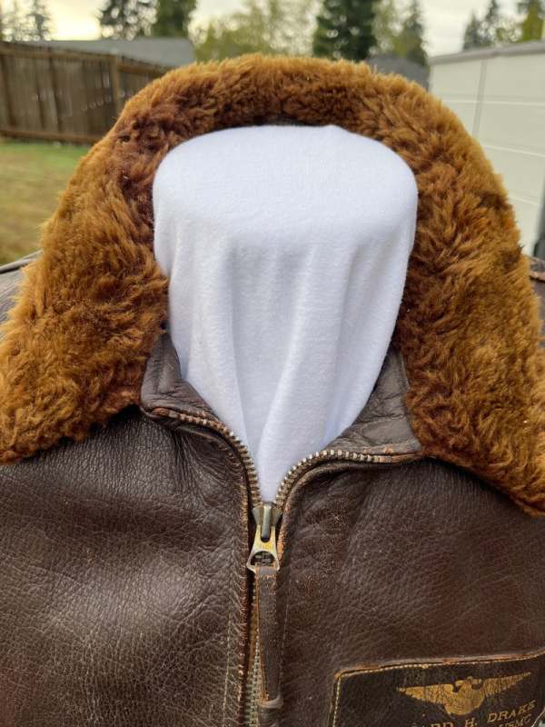

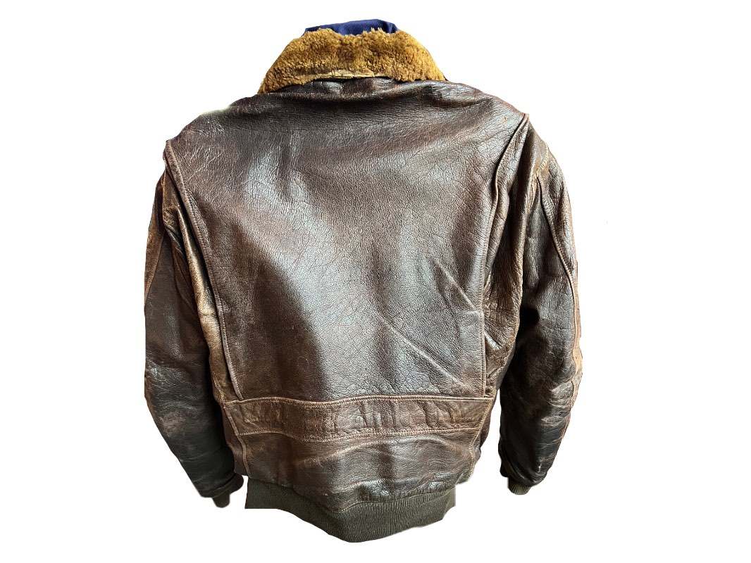

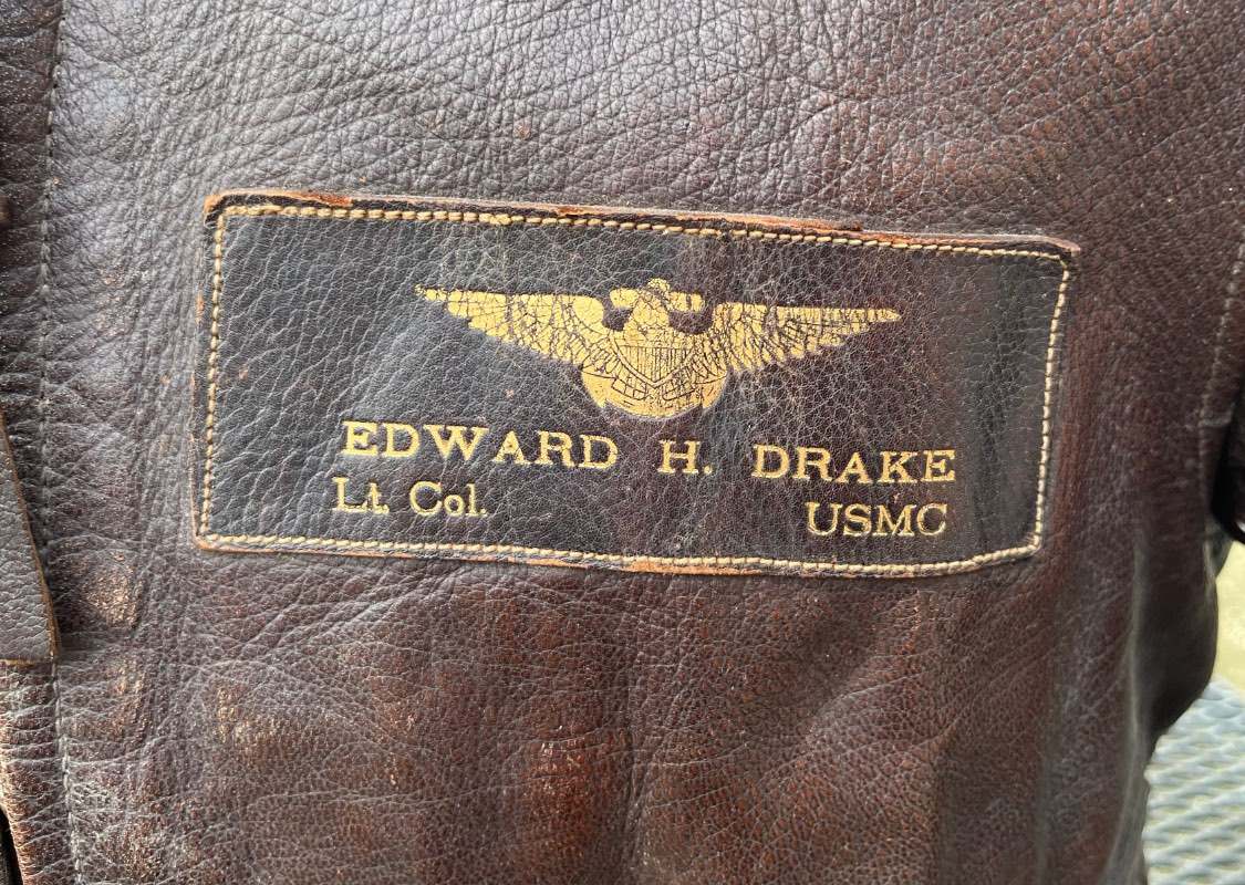

Nice WWII Gordon & Ferguson M-422A US Navy Flight Jacket to Lt Col. Edward Drake USMC.
He has some interesting service.  On December 7, 1941 he was serving on the USS Nevada as a Captain and was present on the ship during the Pearl Harbor attack.
After Pearl Harbor he went back to the USA and received flight training and became a Naval Aviator as a Major.  He served at the Naval Air Stations in Pensacola, New Orleans and Parris Island.
On July 24, 1943 he crashed an SBD into Lake Michigan during carrier landing trials and he survived the accident with only multiple contusions to his head and face. The aircraft was later recovered and is on display at the Naval Aviation Museum in Pensacola.
In 1944 he left aviation transferred back to ground duty and commanded a Bn of the 21stMarines in 1945.
This jacket is all original and has not been messed around with.

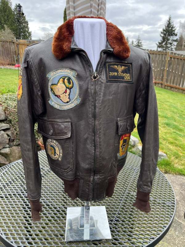

When comes to flight jackets, I mostly collect USN Jackets from WWII and Korea, but I always kept it in the back of my mind to look for a decent un-messed with Vietnam vintage jacket.
I finally found one I liked.

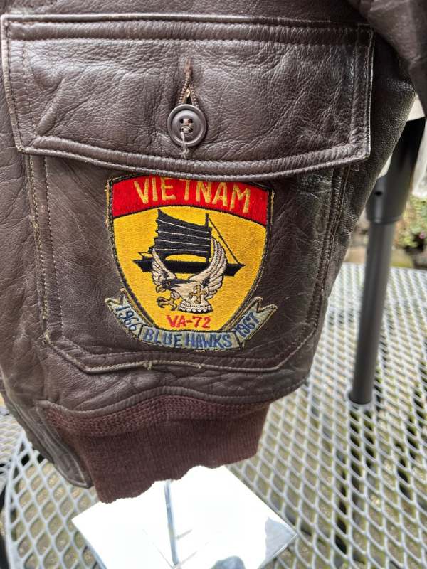

John Stevens flew with VA-72 over Vietnam in 1966 and 1967 earning an Air Medal and Navy Commendation Medal.
I have never seen a Loyal Order of the Re Sam patch before .
He also sewed a couple of novelty patches inside the jacket as well .

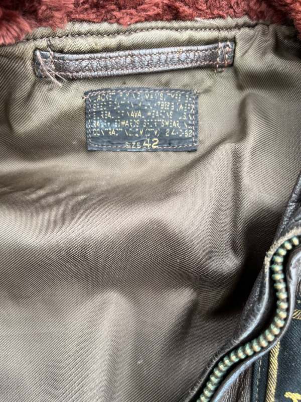

The jacket is from a 1962 dated Ralph Edwards Sportswear contract.

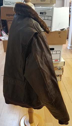

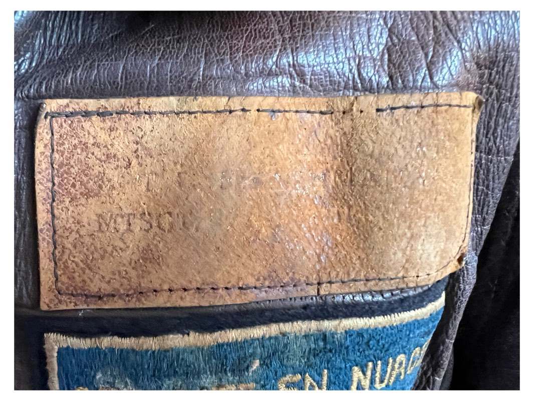

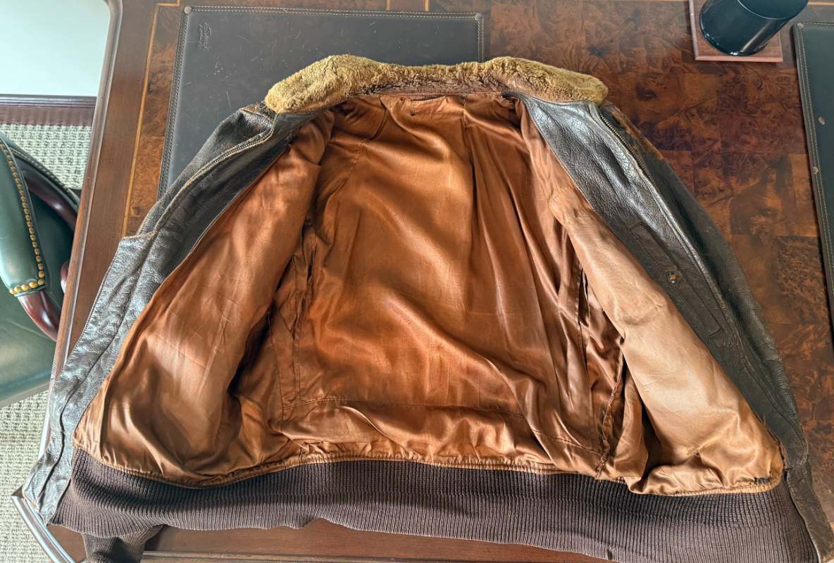

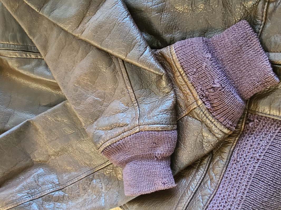

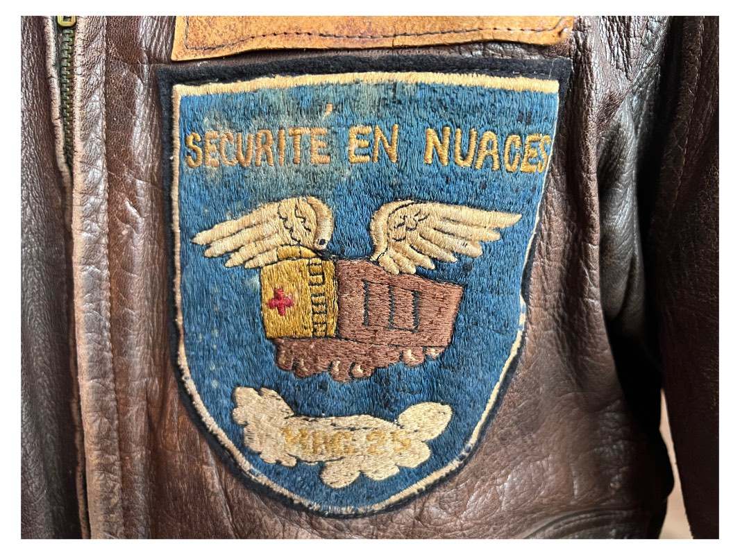

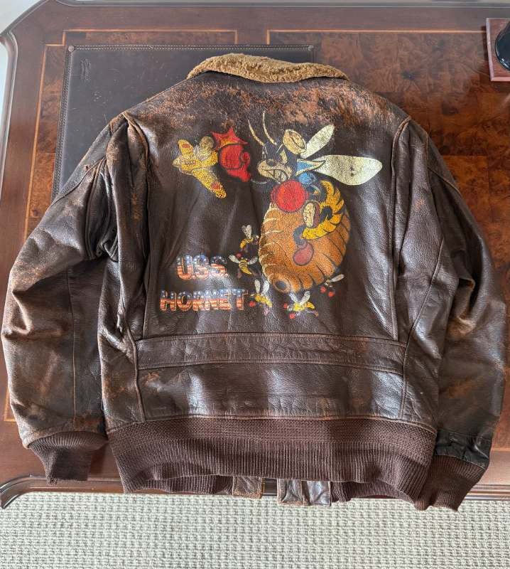

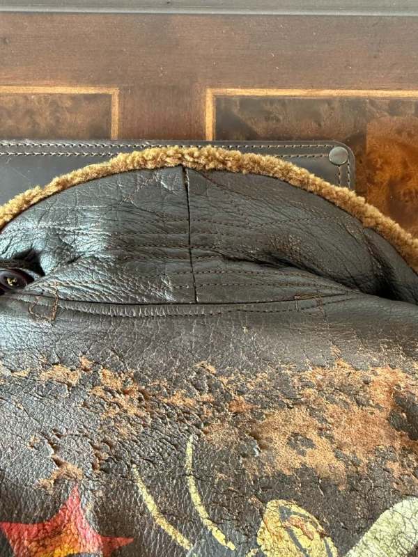

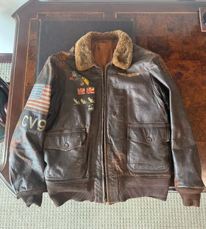

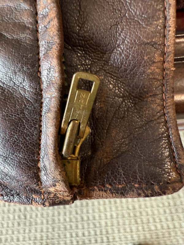

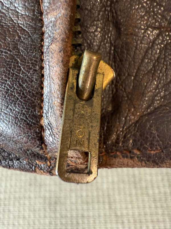

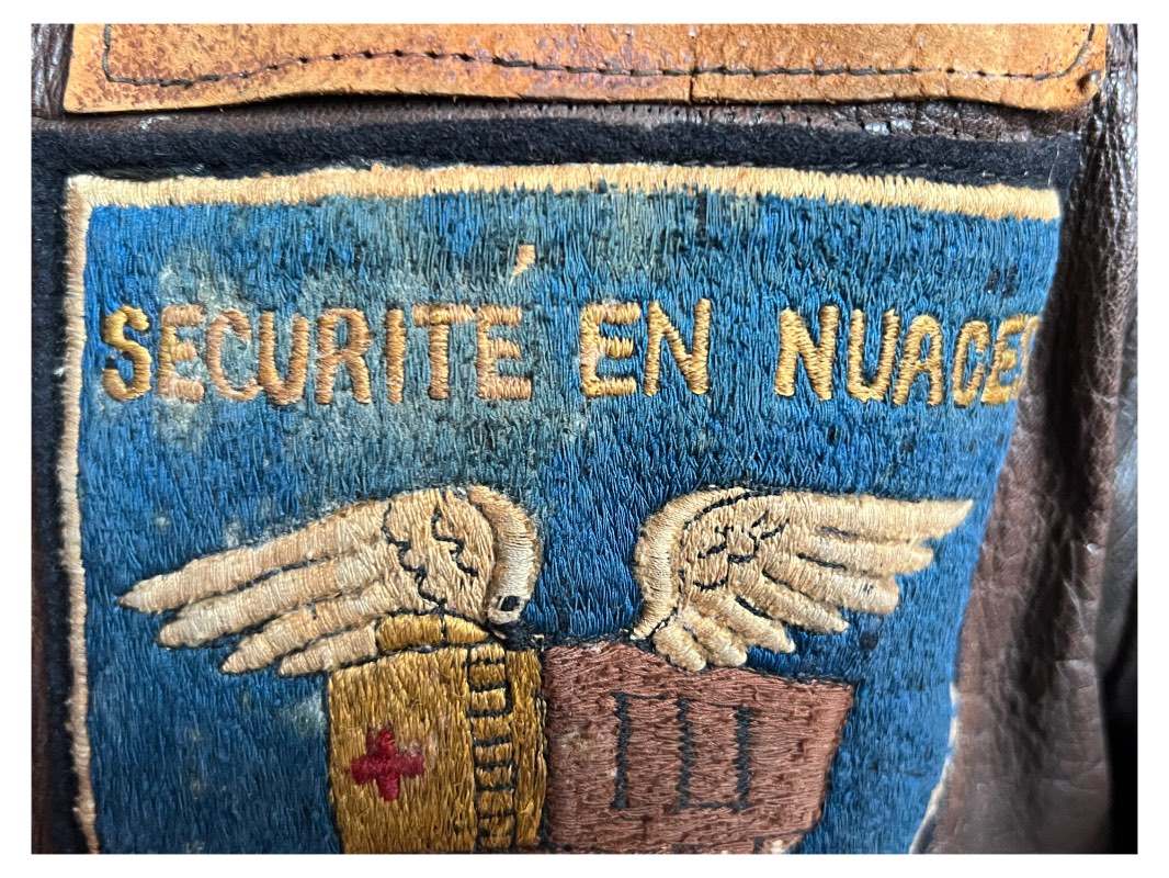

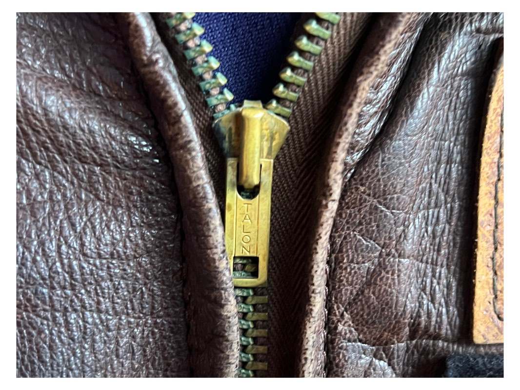

Guys,
I have no experience in these types of items but happened into this jacket.   Can anyone comment on these pictures?
