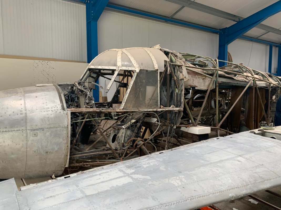

I'm currently working with a couple of friends to help find a rudder for this MK19 Anson currently being restored at Carew Cheriton near Tenby. This aircraft was based at Halfpenny Green airfield with the Air Scouts in the 1970's before being acquired by Coventry Air Museum where it was stored outside for many years. At which point we know the rudder was with the aircraft but not on the aircraft. Acquired some years later by an air museum at Gloucester where it became even more derelict. Aircraft was bought by Carew Cheriton and now is slowly being restored to exhibit condition. During the hunt for the rudder, drawings of same so we can remake one I came across an old member of the Birmingham MVT and West Midlands Battle Re-Enactment Group , Gary Hancock, who is now Aircraft Conservation Manager at Yorkshire Air Museum at Elvington. I met up with him yesterday to take a look at their Anson Mk19 and to see what they had in the way of drawings. Even after 40 years we still recognised each other. Small world.

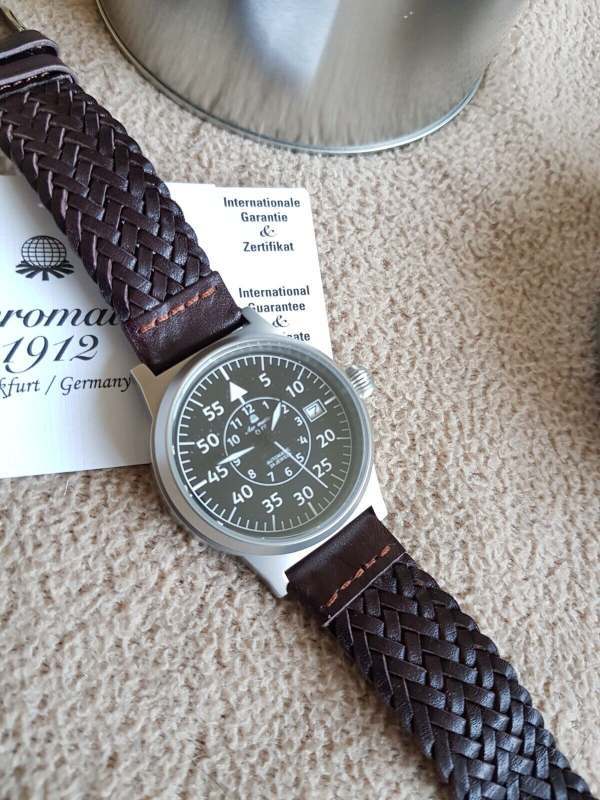

Both of my original movements were refurbished with reproduction canvas straps, so no problem there.
My Aeromatic 1912 wanna-be-aviator watch went through 3 bands before I lost it last week. Meh.
Got this one on the way for now.

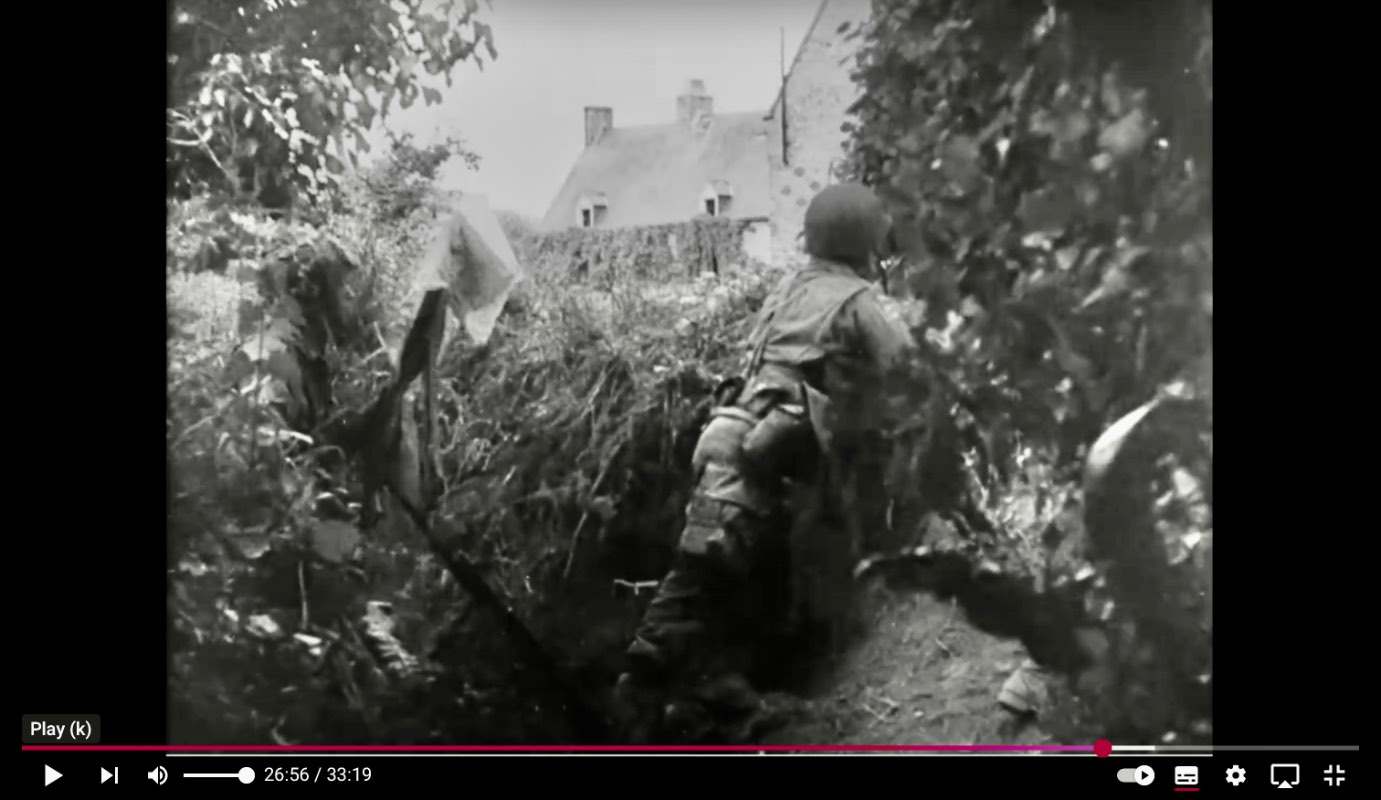

today's then and now . . . . . . . .
this comparison worked in an opposite way to my normal Then & Now's,   I have always known of the action at this farm and then recognised the building whilst watching a video about the battles of Normandy.  I didn't have the video screen grab with me so I made a rough comparison of the two images from memory remembering the two roof windows, unfortunately I shot the right end side of the building and needed the left end side  of the building, I'll take a better comparison next time I am passing.

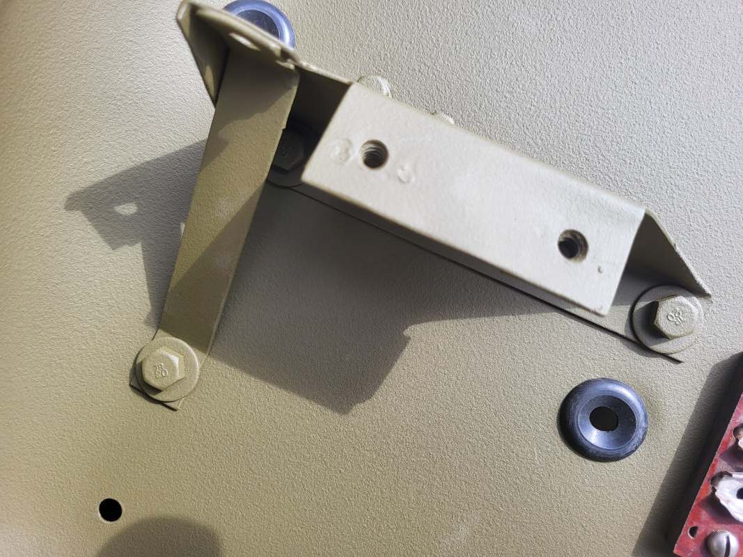

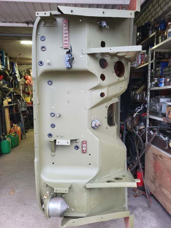

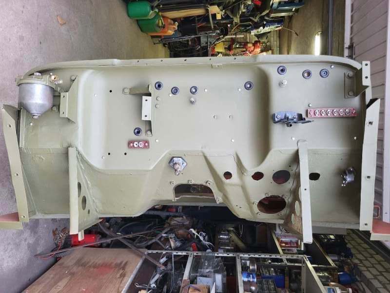

Made some progress on the jeep again yesterday. I put all the grommets (rubber for an early production jeep) in the firewall; there are a few different internal sizes so I hope I put all in the correct places 🤭 After that I put in the firewall padding, this is a 3-section part made of cardboard with a black layer on one side. It is fitted with round head machine screws and special clips instead of washers and nuts to avoid pulling them through the cardboard when tightening. Earlier I managed to rescue a few original screws and clips and re-used these. I also found out the foot starter switch was actually installed with the nuts on the inside, so I changed those.
All grommets in place, and the bright heads of the padding screws:
I forgot a pic of the padding in place, so that will follow later. Some lovely original TR20-marked bolts:

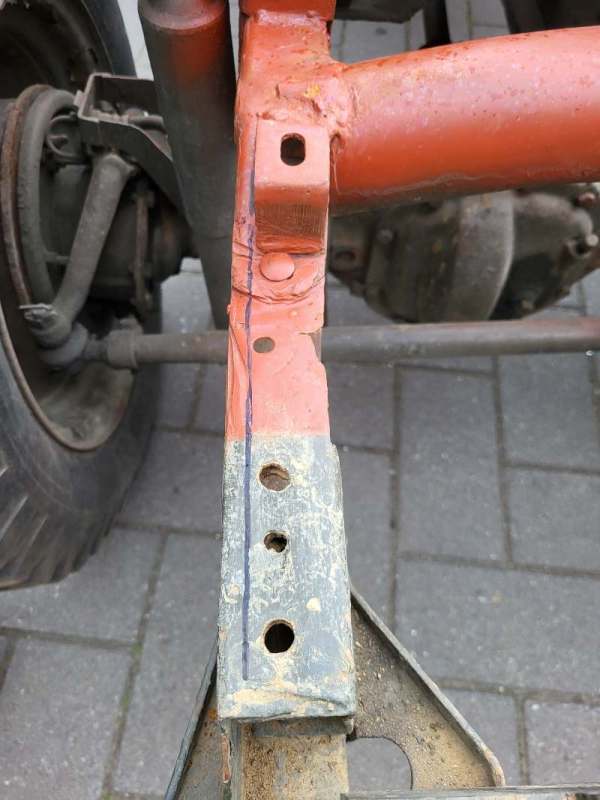

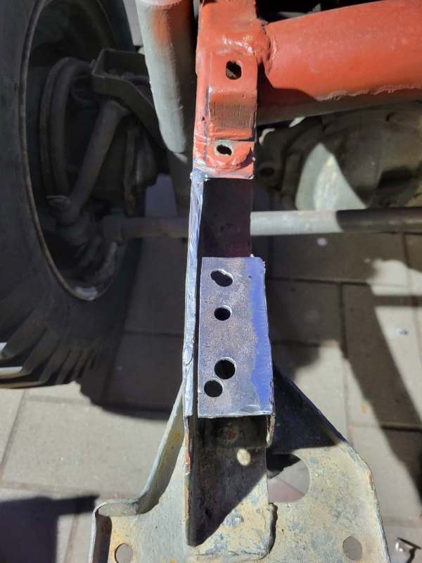

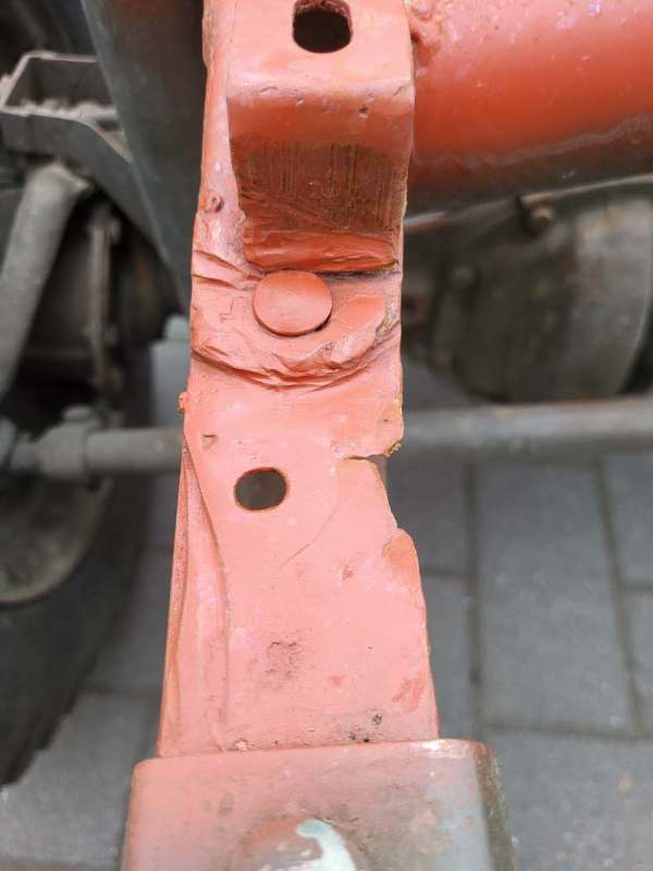

I also started a bigger job. This jeep spent 50 years on a Montana farm and during that time something big was welded to the front, possibly a snow plow. When we got it it had a heavy steel C-profile as a front bumper. Back then we removed a lot of thick welds and made a few to look like the feet of the grille brackets (with coach bolts as fax rivets), but the front horns of the frame (between grille and bumper) were damaged and at some spots very thin on the top so I will rebuild this area.
Coach bolts were also (incorrectly) used to fix the front bumper to the gussets and the holes for the bolts were modified for these. The front horns are very likely a tiny bit out of alignment, but I have no way to correct that so I'll just see how I'll make the bumper fit later. I can always weld shut and re-drill holes.

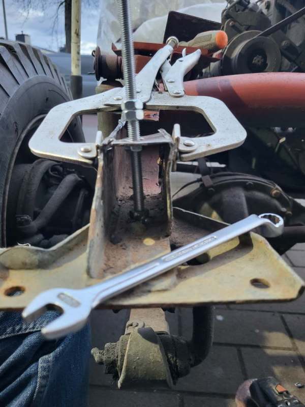

I will remove the top of the main C-profile of the front horn till under the grille bracket, and recreate the front foot of this. The slightly smaller section of C-profile that is inside the main frame rail to form a metal box is riveted in place originally. This section too had 2 non-original holes in it and was warped a bit, so it took some work to straighten out.
I have welded shut the 2 non-original holes and also welded the gap between the inner C-profile to the main rail that you can see on the left side. This is not original, but since the new top rivets will be faux this will add some extra strength.

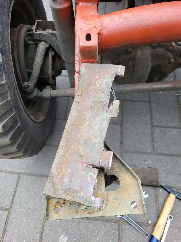

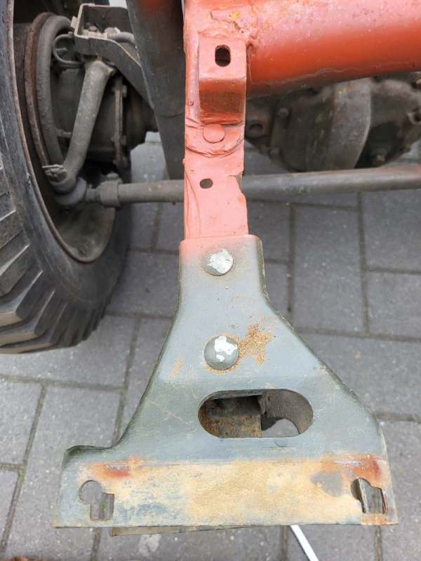

The metal of the main frame rail is 3 mm thick, so I dove into my scrap box to see if I had something that would fit. Luckily I did in fact find enough correct material there to make tops for both front horns and front feet for the grille brackets. These pieces actually came off the jeep earlier, anyone recognize them? 😊

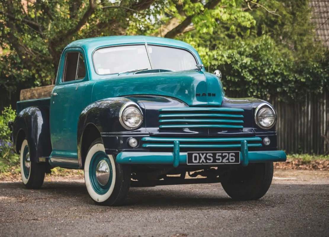

Hi mikie,
This little beauty a 1946 Nash slipped by in a UK  auction in 2023 without  me seeing or hearing of it,

Hi earlymb,
Looking great all OD with grommets and parts fitted, strange though that you have shelving on the floor and ceiling . . . . . . . 😂 😂
Look forward to seeing more of the rebuild as and when you are ready.

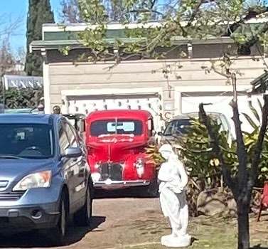

Gunji spotted a vintage pickup today that may be more to your liking. It was off the street so hard to get a good picture. We are not in your league on these things but Gunji’s guess is 1940ish Ford?
