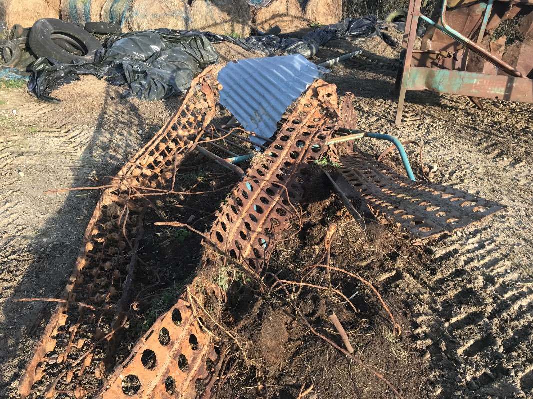

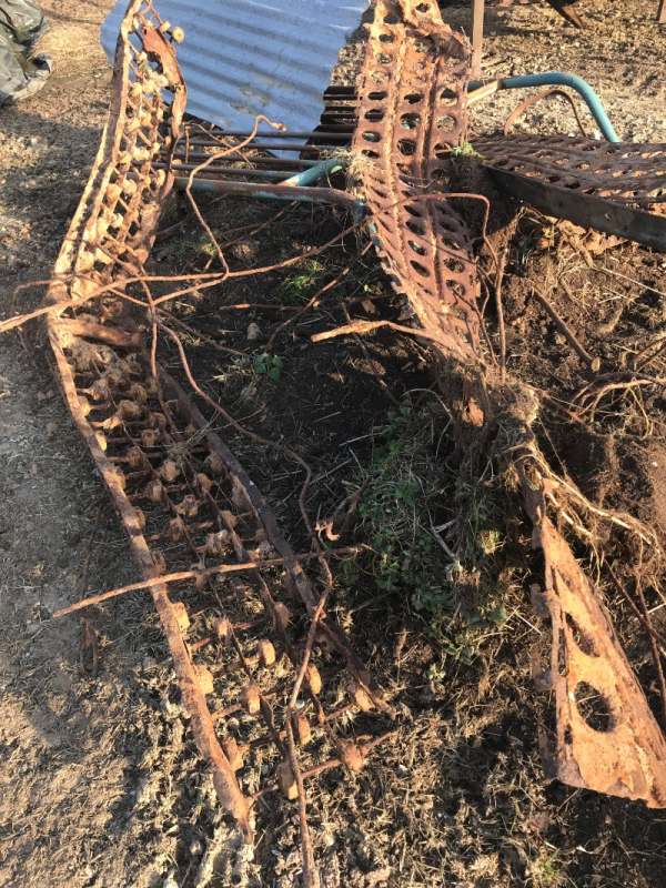

I had a spin out in the Jeep this afternoon, passing a farm entrance I spotted some recognisable pieces in the yard. I looped around and parked in the entrance and took these photographs of a couple of sheets of PSP planking and a mangled set of rollers the farmer had recovered from his fields.  The rollers were used for easy movement of ammunition, food, and  spares crates etc in storage areas, hidden in the ground these last eighty years. . . . . . . . . . . . . . . . .

That's a great find! They would look great in your garden, I'm sure they'd fit in the jeep and the farmer won't mind if you ask nicely 🤭

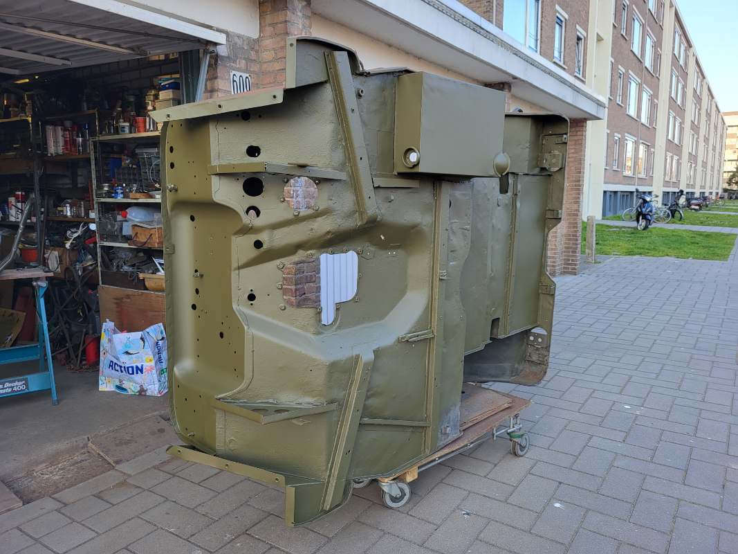

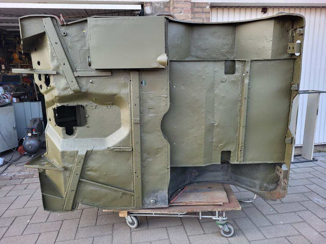

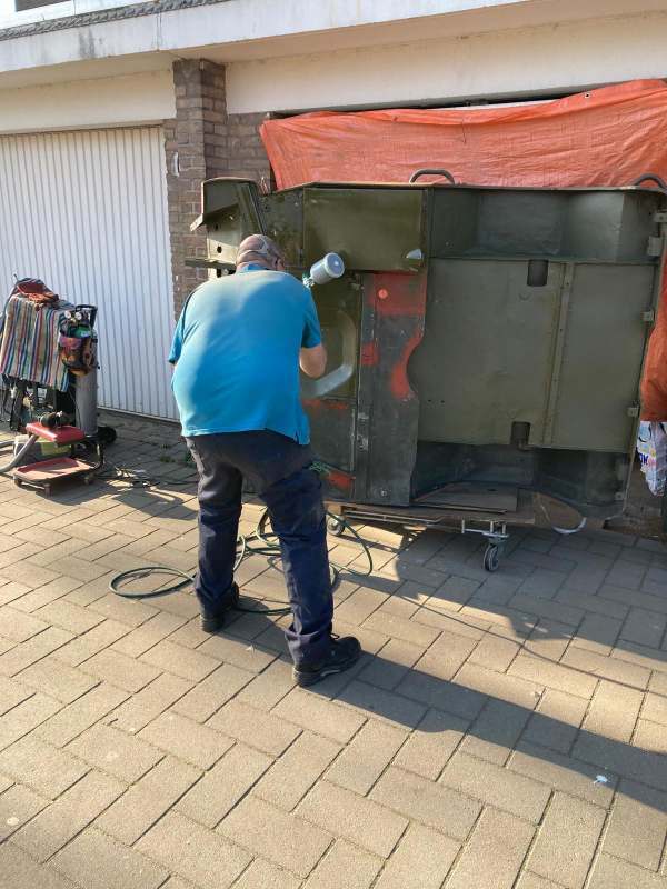

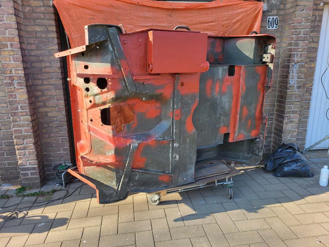

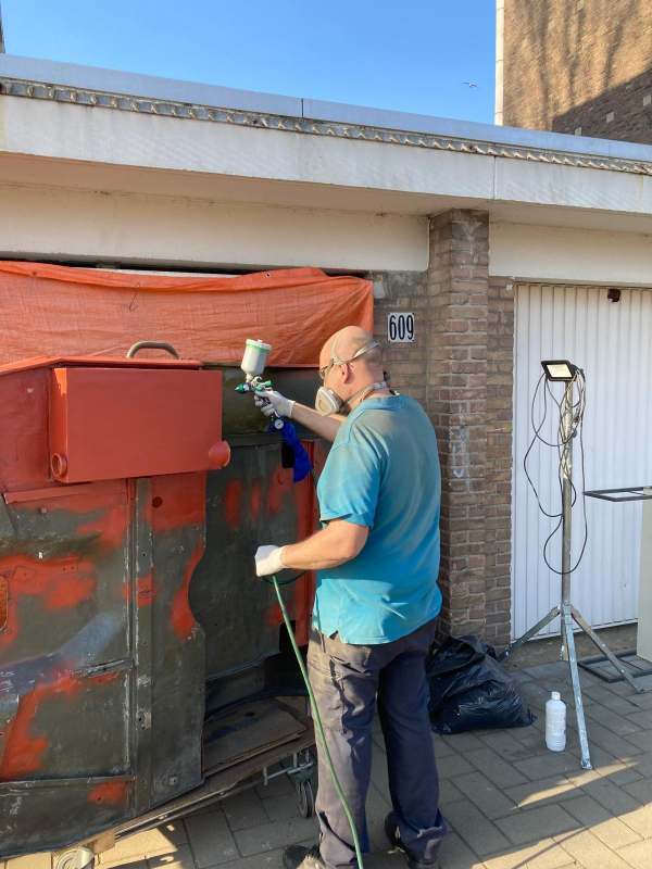

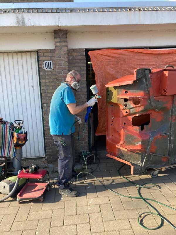

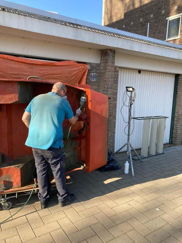

Yesterday I made a big step with my jeep as well. After sanding, cleaning, welding up some forgotten holes last-minute, priming, sanding and more cleaning I got the first coat of MAT 1 OD on her! 😍
The weather was perfect for painting, about 15C with a bright blue sky and almost no wind. The areas painted were both sides of the fire wall, the dashboard and the underside of the entire floor, minus the right rear wheel well and the area just in front of it as those require some more work before they're ready for paint. Rather than lay on the ground I'll just put the body on the other side on the trolley.
Having no choice really I hung a tarp on my garage door and sprayed the body on the pavement right in front of it, being careful to avoid overspray but all went well. I used a cheap ($25) spray gun from Temu, a 10 mtr air hose and a small compressor with a 20 ltr tank and it worked just perfect; the paint going on smoothly and evenly without any issues like drips.
After this first coat dried a bit I put the brackets for the air cleaner and for the horn back on the body as Johan mentioned earlier so when I give these areas a second coat these parts together with their (original) bolts will be sprayed too, as originally. When this second coat has had some time to cure as well I will put things like starter switch, high-low beam foot switch, oil can holder and junction blocks on before fitting the fire wall padding. At this time I will also apply the brick sealer to the underside and fire wall.

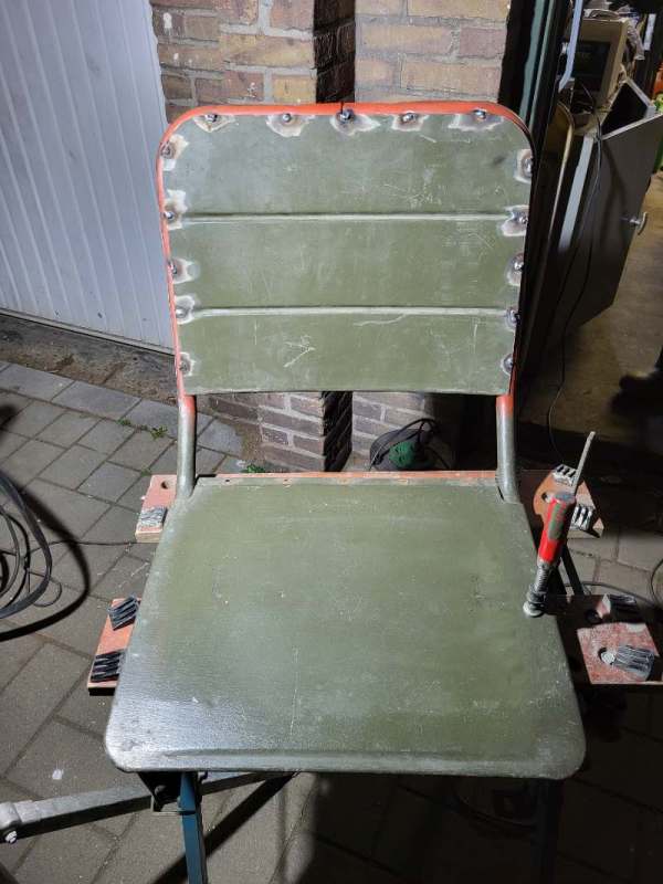

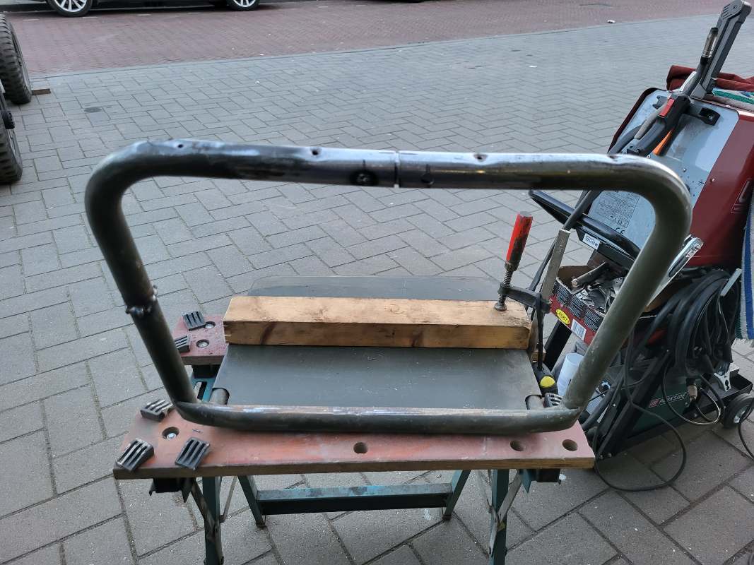

Another job done was to modify the passenger seat so it now has the typical early split-frame. By now it was too late at night to grind the welds, so I'll finish it next week.
Obviously the paint will need some time to cure and harden between layers, so in the meanwhile I will start with the frame. That needs some work done to both front horns, but for the rest it seems it will mainly be cleaning and painting. Cleaning the engine block so the fresh paint won't peel off in a few months will be quite a job, and I will add some correct parts to it as well. I'm still looking for a oil filter housing, but later this month there is a MV parts fair and I hope to find something there. In the worst case I'll put the post-war housing back till I get the correct one.

a great deal of work and effort,   but great to see a more authentic shade of OD than what was previously on it.

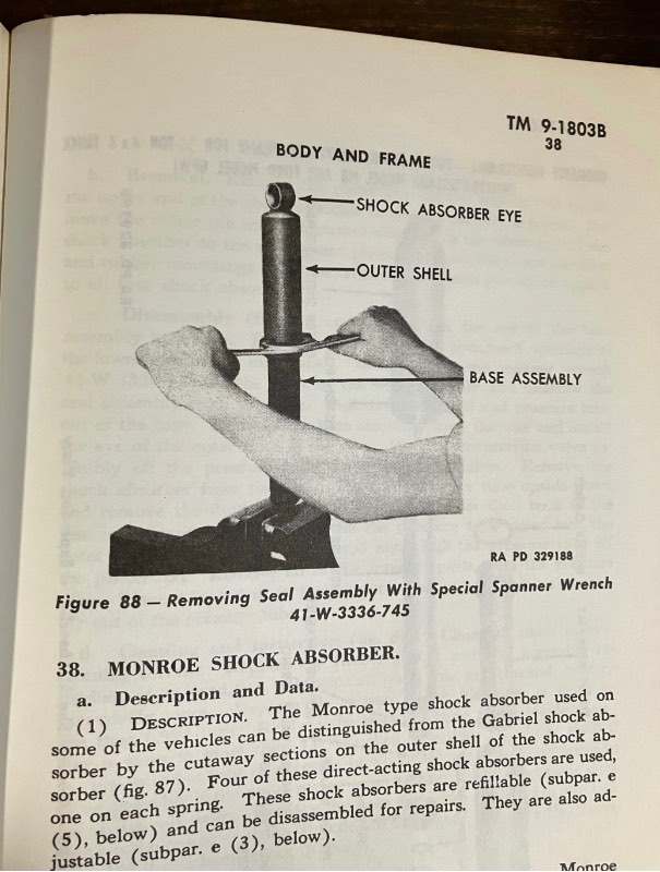

A few posts back I made reference that I had saved several old take-out shock absorbers from damaged or abandoned Jeeps we broke for spares in the 1970's.  The ones shown below are Monroe Automotive ones, ( note the small fold out pieces for tool access ) these feature in the later Jeep manual TM9 1803B, April 1944, it was possible to take these apart and refill them and re-fit which helped save on materials, manufacture, transport and stocking during the war, I have never had to do this, having had sufficient NOS stocks.
I have to thank Johan for locating which manual these featured in, I couldn't recall where without spending time looking through all the manuals I have in my collection.

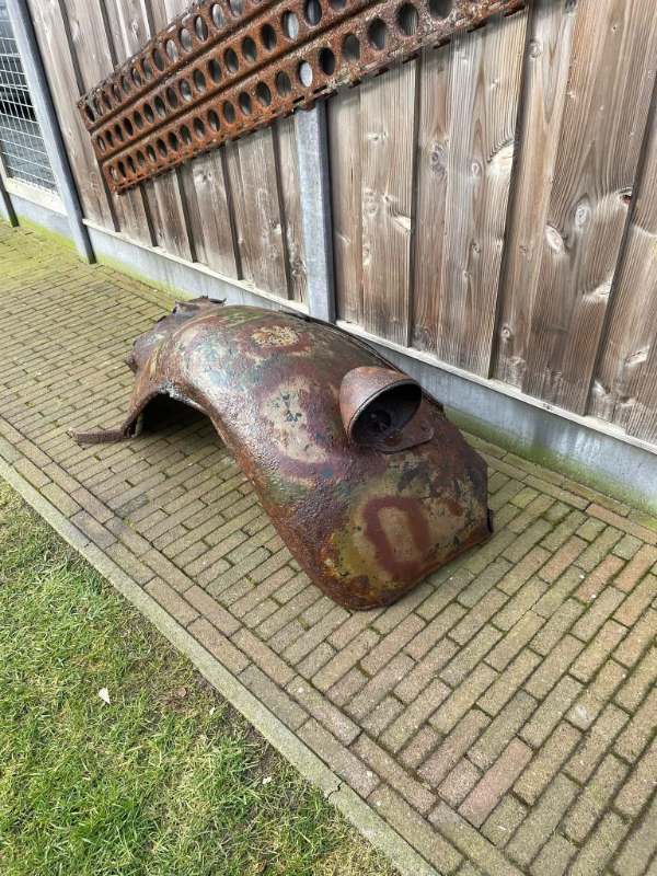

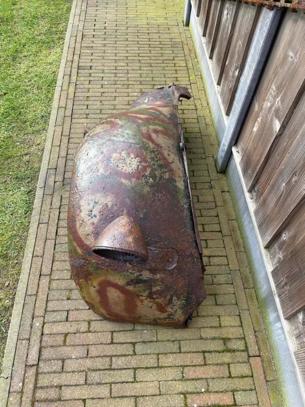

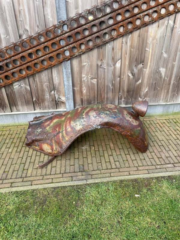

saw this n FB post and thought it may be of interest here. Original fender with the war time paint intact.

Ron, how much is it? Is it in the US?
recall its in Europe and wasnt for sale

The architecture didn’t look US.

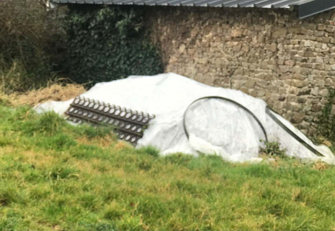

At the roadside today . . . . . . .
A length of wartime PSP planking holding down a weatherproof sheet over a pile of logs .

OK, I hope I don’t become an offender by asking, but what vehicle is this off of?
mikie
I can't readily place the light fixture mount....Simca 5 staff car maybe?
General Apathy
Hi Flibble,
Here's a wartime photo of the Fiat designed Simca 5, in production 1936 till 1948, obviously with reduced manufacture during the war years.
