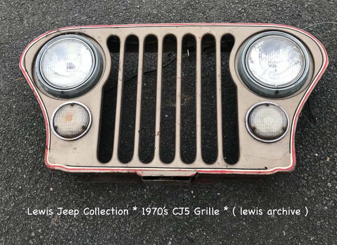

General Apathy
Another wall hanger . . . . . .
Last week looking through storage I re-found one of two CJ5 Jeep grilles I saved from wrecked Jeeps I bought back in the late 70's to break for spares for the CJ5 I owned.
I decided it would be better suited hanging on the garage wall rather than hidden away.

Neat! It would be cool to wire up the headlights!

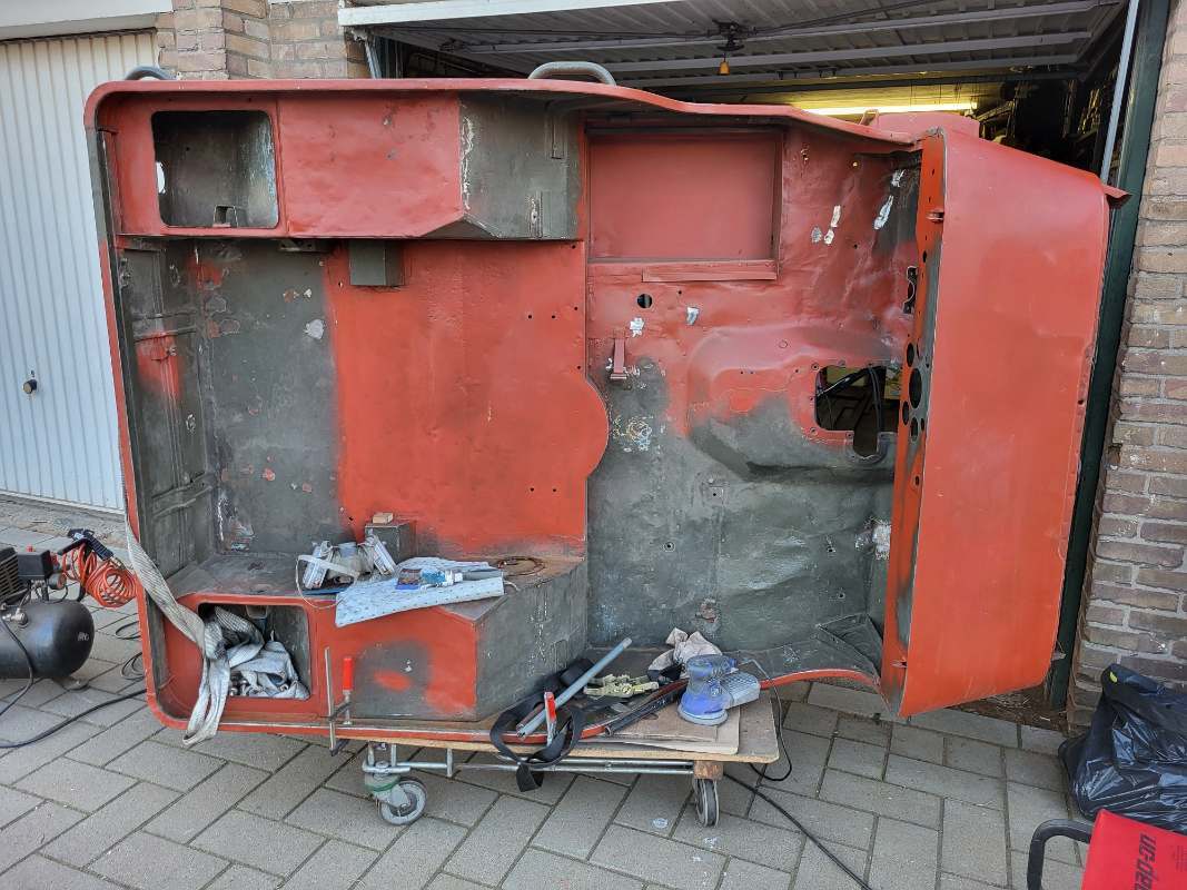

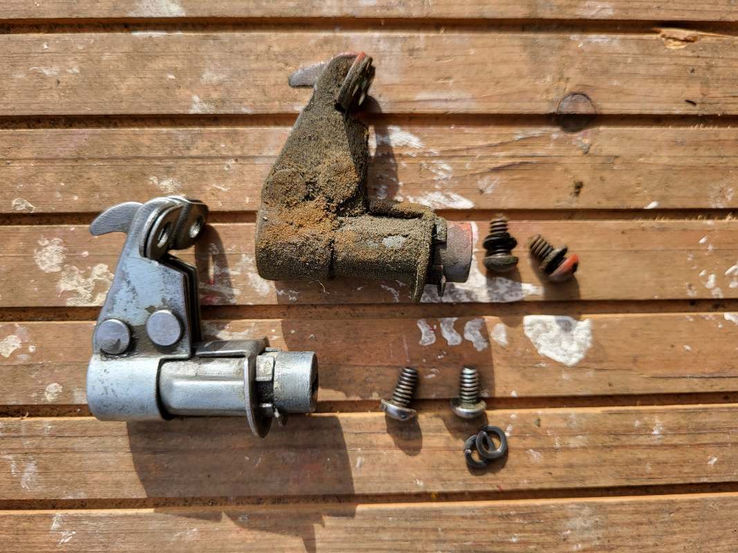

The last few weeks I've been plodding on with the jeep with nothing major to report; mainly cleaning up, stripping and priming area's and welding up lots of holes, small patches etc.
I have sorted out on of my pet peeves though; a visible weld line at the rear of the floor just in front of the rear seat between the shock towers. The rear of the floor had to be replaced 30 years ago but they used a lap joint (one sheet slightly overlapping the other, giving a visible weld) instead of a butt joint where the edges of the metal lay next to each other and the seam is welded shut meaning it can be ground flush and becomes invisible. The rear floor is a single piece originally so a visible weld joint is incorrect. From the top the weld is gone, but at the bottom I didn't grind it flush so the joint retains its full strength. This the result (unfortunately I don't seem to have a photo of the visible seam):
Sometime during her life she got some accident damage to the left rear corner of the body, nothing major but it did require some hammering and some body filler to take the worst dents out. I don't mind if you can see the body is 83 years old but this damage was just a bit too much to leave as is. Previously it was nice and smooth under the thick coat of filler; too thick to my taste. Here it is during one of the stages of applying filler, letting it dry, sand everything smooth, apply some more filler to a few low spots and repeat. The area is now primed and coming weekend I'll check if it is ready for the first coat of OD or some more work is required.
I'm also continuing preparing the small parts in between the bigger jobs; last Saturday I cleaned and lubed the original locks of the rear lockers. They function just fine and are ready to go back in. These work on the standard H700 key that literally anyone can buy from parts vendors...
No photo's but the dashboard is stripped of all paint now and is ready for a coat of primer. Slowly but surely we approach the point where we can clean the bottom of the floor, both sides of the firewall and the dashboard for the first coat of OD paint. 🥰

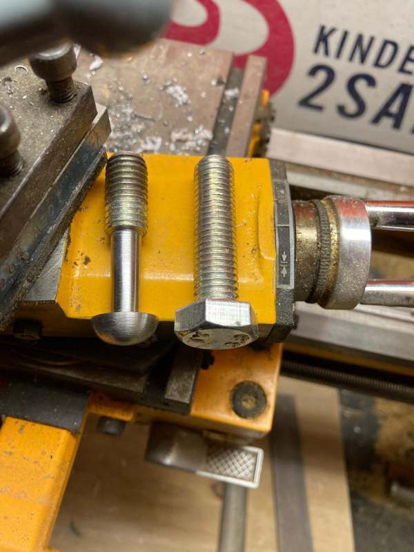

When the underside of the floor is done we'll start with the rolling frame, that requires some work to the front horns. It will need some replacement metal and welding, and 4 new rivets for the upper bumper gussets. Unfortunately while these can be found in the correct size here, I would have to buy at least 100. So we got 4 bolts with heads a bit bigger than the correct diameter of the head of the original rivets (16.7mm). My friend then turned them to half domes on his lathe; this was quite a time-consuming job but I think they came out amazing!
They will replace the carriage bolts I have now, which are both too big in diameter and too flat. The threaded sections will be cut off, the rest trimmed to length and then I'll weld the from the underside as it will be an optical repair only.

Hi mikie,   not that I need any walking aids, but someone could take this idea and make a Jeep version with working headlights and indicators  . . . . . . . 🤣 🤣 🤣

Thanks Ken!
I need to weld in the rear stone guard for the tank against the front or the rear wheel housing, just above the sump. Then, after final sanding and cleaning, I'll spray the underside of the tub, both sides of the firewall and the dashboard with 2-3 layers of MAT 1, followed by 1 or 2 layers of the brick sealer (obviously with some time between coats to dry).
The first fresh parts going back on will be the rubber grommets in the firewall, the oil can holder and the most useless part ever fitted to a jeep: the cardboard isolation on the inside of the firewall. After this I can fit the main wire loom and the various switches and set aside the body to work on the frame. The sides and inside of the tub can be stripped, cleaned, primed and painted when the body is bolted back on the frame.
When most of the parts (fenders, hood, grill etc.) are back on I'll give it another, overall coat (or maybe 2) of MAT 1. I won't do the factory-correct overspray under the hood, as I just don't like how that looks.

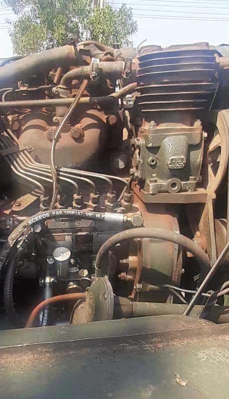

Latest find . . . . . . . . .
John is coming to the end of their south-East Asia tour and in the last few days spotted this left behind US truck in the street, the hood was up and he took a shot of the engine currently in it, uncertain if this is the original or a replacement, post WWII vehicles are outside our experience.
I mailed him saying it was just what he needed for their supermarket runs in London and he should build a larger garage.
Norman D. Landing, Forum Normandy Correspondent, March 06  2025.
No idea if it's the original multi-fuel turbo engine either, but at least it does look well maintained. These things are called 'Whistlers' for a reason, but they are pretty fast for army trucks 🤭

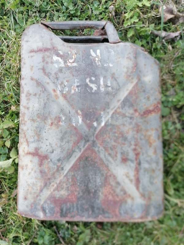

Bonjour.
While doing a little tidying up, I rediscovered this jerry can.
Ok, since jerrycans seem to be the topic of the day, I saw this one at a flea market last weekend. Too much junk in the way for me to get a close look at it. I have no idea if you can deduce anything from just this picture.
mikie
I would say it looks to be in pretty good condition, with original paint. To further assess it you'd need to check if the inside is clean and the bottom for the date and rust holes. They are great collectables but do take up some space.
