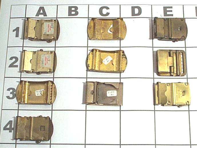

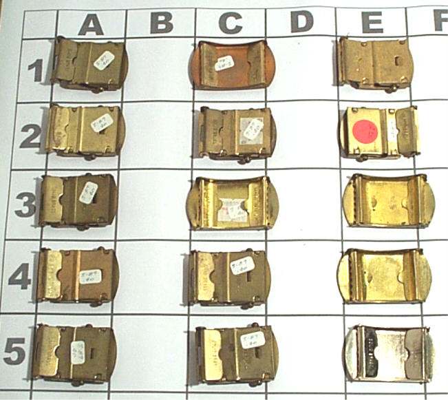

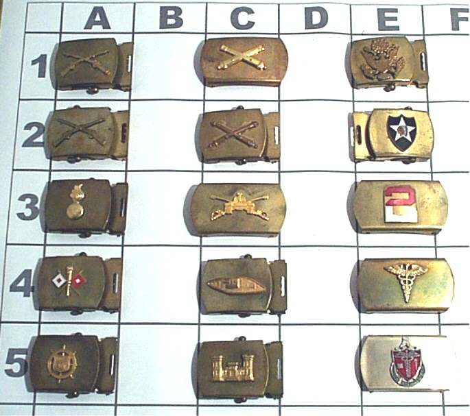

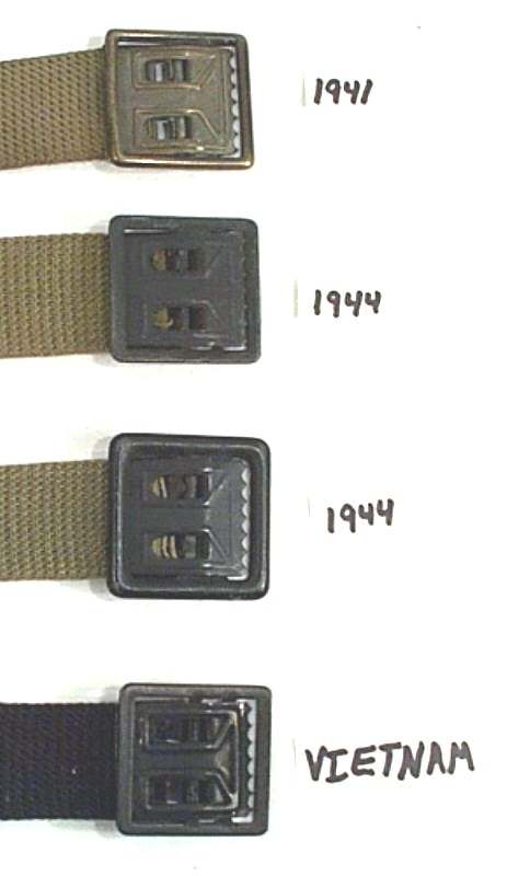

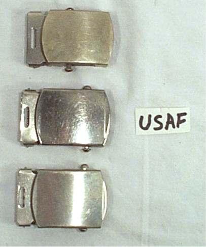

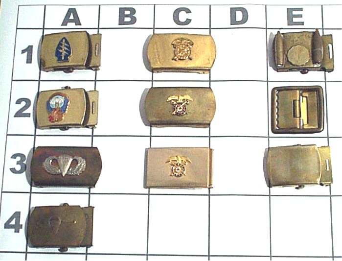

craig_pickrall Posted December 31, 2007 #7 Posted December 31, 2007 I do not recall ever seeing a silver buckle before the USAF became a separate branch of service in 1947. Maybe someone can correct me on this. I did the attached photo spread about 4 years ago. At the time I had a broken arm so had some help with the layout and labels. This could be improved on a good deal but at the least it will give you some pics for discussion.
Wailuna Posted December 31, 2007 #11 Posted December 31, 2007 I do not recall ever seeing a silver buckle before the USAF became a separate branch of service in 1947. Maybe someone can correct me on this. Nice belt and buckle display, craig. This pretty well covers Greg's questions. As to "silver" (or "white") colored Army buckles, I believe you do have a sample of one at position E-5 in post #8 (with the Medical DI affixed). At least, that is the color I took to be the basis for Greg's question regarding "silver" Army buckles. Buckles this color were in vogue when I was a young soldier (after Korea and before Vietnam). Collar and service hat insignia came in this material as well. The Army was just then transitioning from OD to Army Green and all those shiny brass buttons and gold braid on the new AG uniform cried out for enhancement. Anodized "white-gold" insignia and buttons for the coat and hat were available and commonly seen (mostly worn by officers, who could afford the cost). These anodized fixtures were authorized for optional wear and were sold at the P.X., but they could not be mixed with ordinary brass insignia on the same uniform. From looking at contemporary uniform regulations (AR 670-1 ed. Feb 2005), I see that "...previously optional white gold anodized aluminum buttons are no longer authorized for wear...." (p.156).

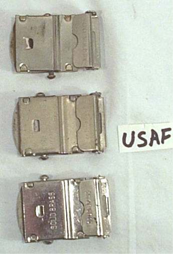

Gregory Posted January 3, 2008 Author #12 Posted January 3, 2008 Friends, Thank you very much, am really very grateful for all your comments, pics show, information. Below you may see why I needed this informational support. Both buckles I posted below I bought as "WWII era". And theoretically it is OK, becuase at least since 1942 I can see the US pilots wearing such buckles. The only one problem is in b-w photography and in doubts "what is what" and if WWII in fact. At the last picture you may also see why I asked for info when the US armed forces initiated oxidizing or parkerizing black the buckles. The pilot at the pic was taken in May 1942 and his buckle looks like never blackened but polished. One more time thank you very much for all you did! Best regards Greg

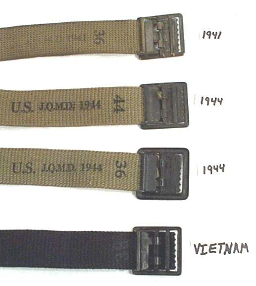

craig_pickrall Posted January 3, 2008 #14 Posted January 3, 2008 Look at post number 7 to see those open face buckles in both brass and non-shiny metal. The pre-war or early war buckles were made of brass and could be shined but later they were made from a grey metal that has no shine to it. Gregory do you have a date on your 2 buckles with the wing and prop? If I had to guess I would say they are post 1947 after the USAF became a separate branch but have nothing to base this on.
Gregory Posted January 3, 2008 Author #15 Posted January 3, 2008 Gregory do you have a date on your 2 buckles with the wing and prop? No, they are unmarked and undated. If I had to guess I would say they are post 1947 after the USAF became a separate branch but have nothing to base this on. That is this problem I came to this topic. No doubt such buckles existed during WWII but how to recognize WWII era ones from post WWII specimens? And maybe they are the same because there are only five years between the USAAF and USAF? Below there are two pics of 1942 where P-38 pilots had the buckles we are talking about.
craig_pickrall Posted January 4, 2008 #16 Posted January 4, 2008 Gregory, I do not collect USAAF / USAF items so probably should not be discussing this but I am curious about these buckles. The reason I think they are post war is that during WW2 the AAF officer insignia was a gold wing with silver prop and usually these belt buckles have the standard branch insignia on them. There are some that have the insignia stamped into the brass buckle but that is not the case with yours. After the USAF became a separate branch and had their uniform specs established they no longer wore the winged prop insignia. I can see at that point why the buckle makers would use single type material rather than 2 color. Hopefully a AF collector that knows about these buckles will sign in and set us straight.

wuzcav Posted February 20, 2022 #25 Posted February 20, 2022 Can someone give an approximate date for the buckle shown in the late Craig Pickrall’s 31 Dec 07 post. Photo #1 Buckle 3E or 5E with a back like photo #2 3C. How was it worn on the belt? I wore and am familiar with the slide type rod in the center. I have a 3E/5E type with ordnance branch screwback insignia and a 3E/5E 11th Cav no hallmark screwback 11A4 type di.
