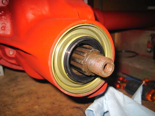

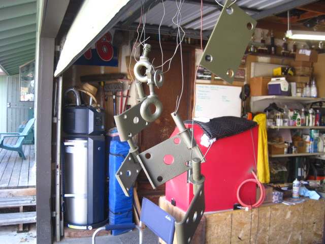

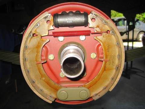

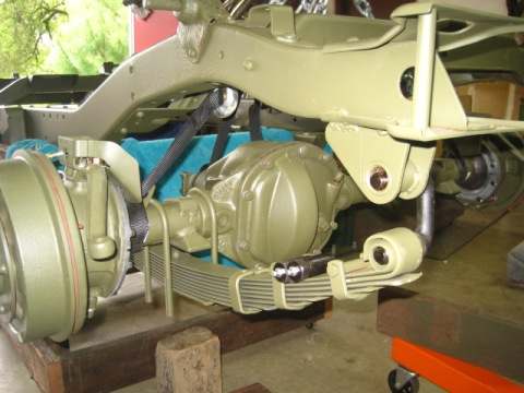

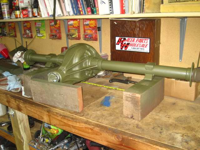

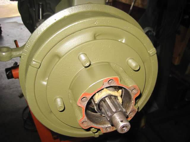

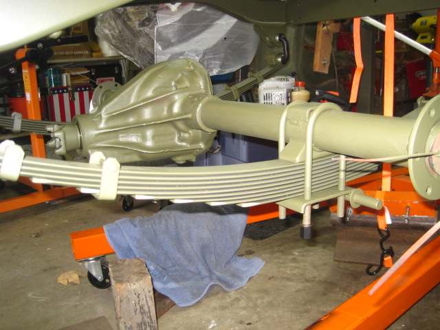

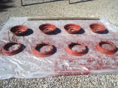

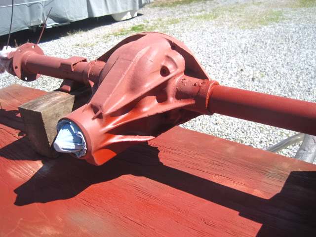

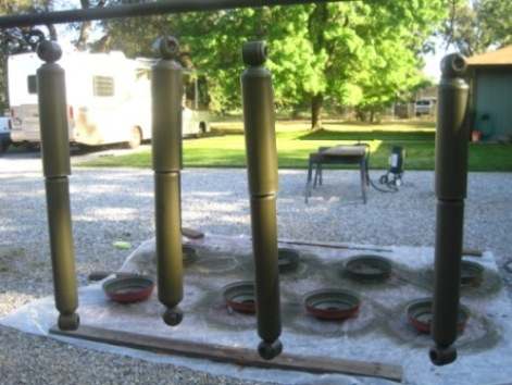

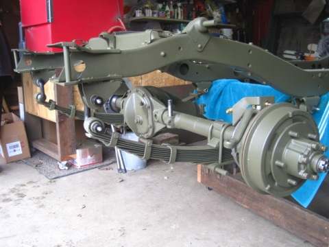

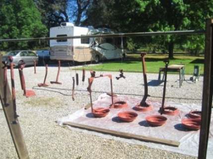

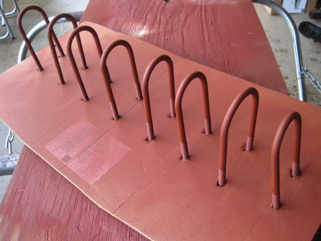

The weather finally broke yesterday and I was able to get some parts cleaned and painted. I think I am finally at the point that I can start assembling components to the frame. The brakes components were also installed on the front axle, and I finally shot some OD on the rear housing. I also shot the final coat of OD on the four leaf spring packs.
More:

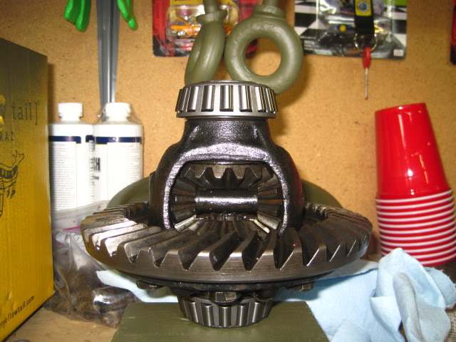

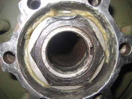

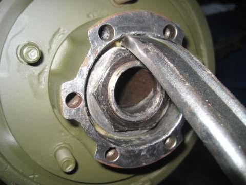

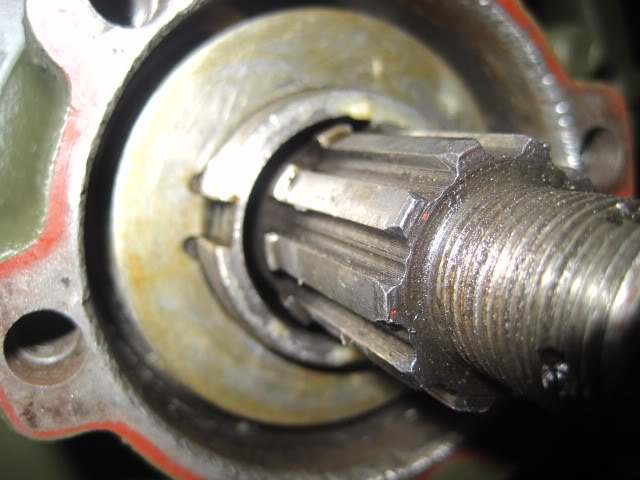

Unfortunately, I had to remove the rear differential carrier and replace the bearings. The bearings are hard to remove, but fairly easy to install:

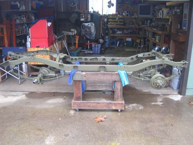

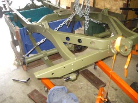

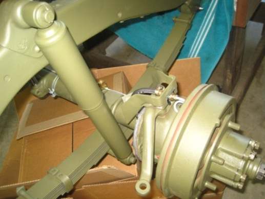

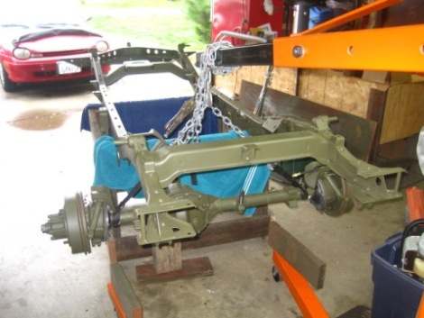

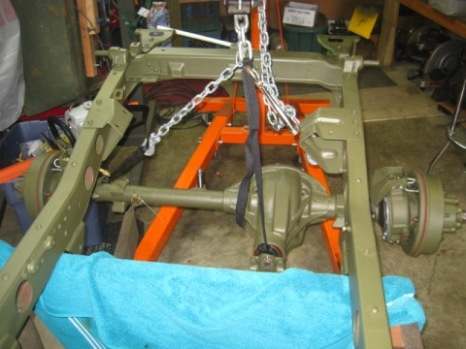

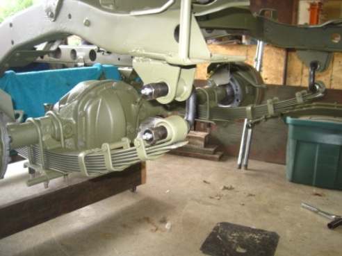

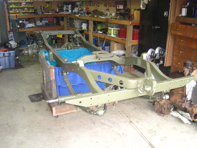

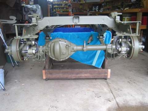

I post updates on the Jeep forum, but like to post here as well for those that may be interested. Anyway, I had yesterday off, and it really felt like it was the first day that assembly has finally begun on my GPW project. Wow, it’s starting to feel like I will need to start looking for a wheel and tire solution soon. Of course, there is still a lot of work to be done before I get there.

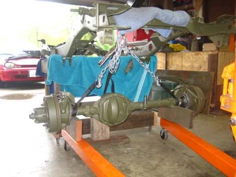

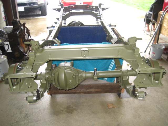

I worked on installing the front and rear axle housings. I don’t have any help, so I’m always trying to solve the movement of heavy parts by my lonesome. I don’t know what the front axle housing weighs, but it is considerable. I’d put it in the double slipped/blown disc category if I were to lift it by myself. Overall, the project ended up not being as big a deal as I thought it might be. Everything went together fairly easily. I also built a little stand on wheels for the frame so that I can work on the brake lines and other components with the chassis up a little higher. It really came in handy installing the axle housings…since it is on wheels…duh! I’m fairly tall and it will come in handy so that I don’t have to bend over as much ….I hope.

Thank you. An overhead crane would be awesome. Thankfully, my engine crane has been very versatile and up to all of my tasks to date.

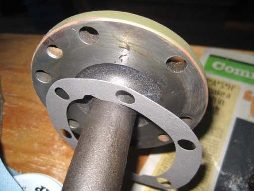

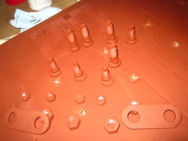

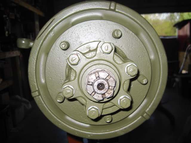

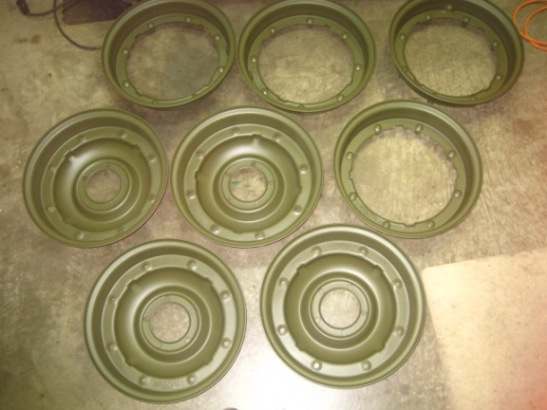

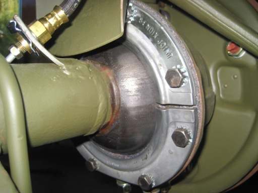

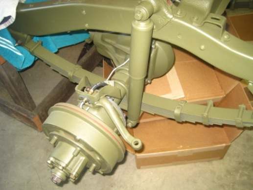

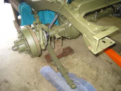

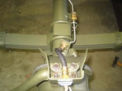

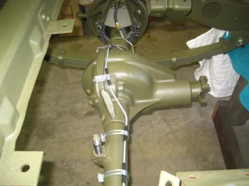

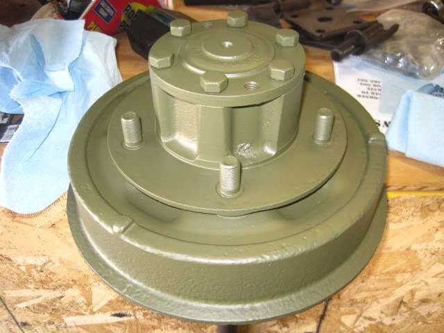

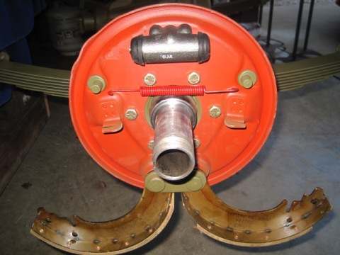

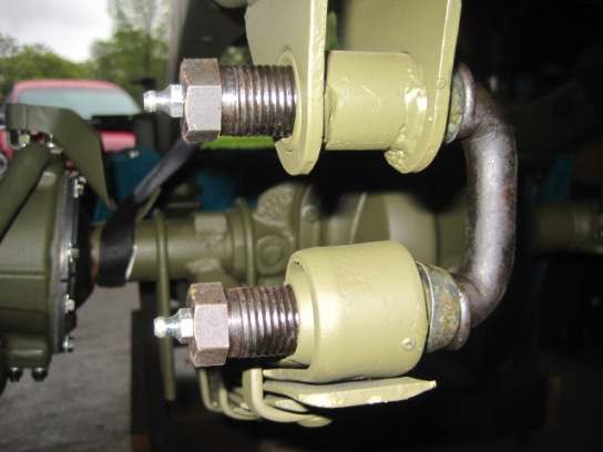

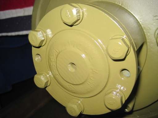

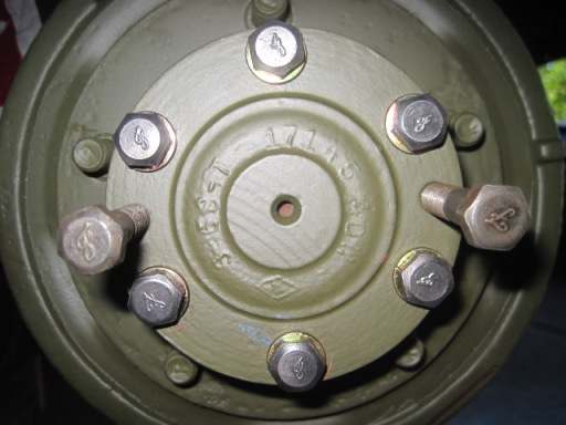

Finished up my rear axle housing. Installed the brakes and the rear axles. I found some f marked bolts for the rear axles. I had some for the front, so of course I had to make it match the front. Now I am working on the brake lines, and I cleaned and painted a lot of parts today including my newly acquired combat wheels.

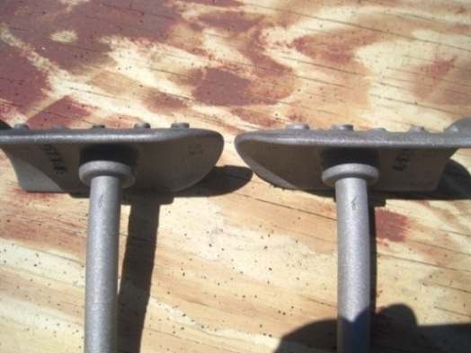

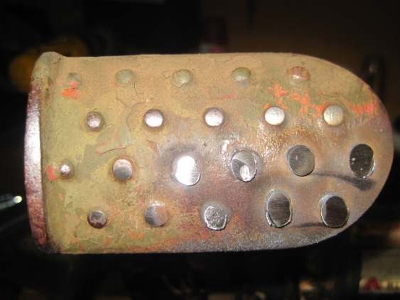

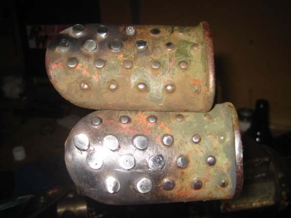

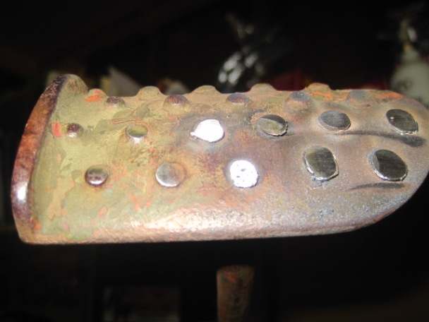

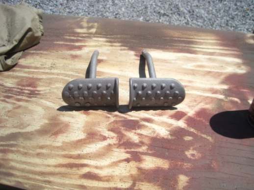

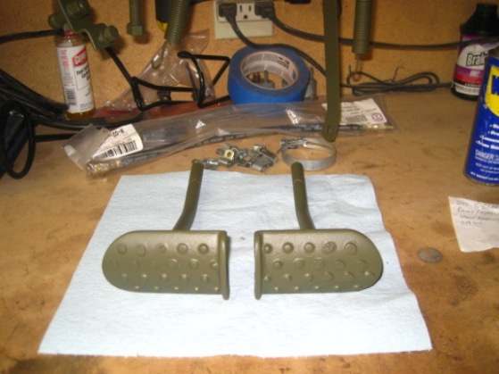

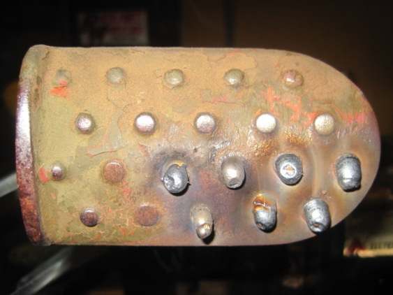

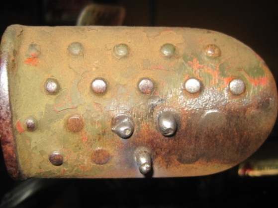

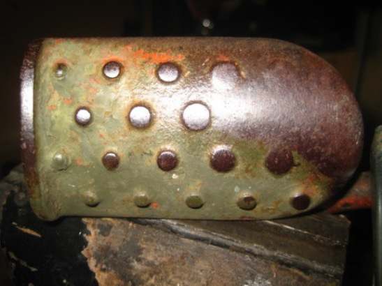

I tried to restore the pedal pads, since the dimples had been worn off over the past 70 years. Not perfect, but it should keep my feet from slipping off.

Thanks guys. Of course you know, I only post the good stuff. With the power of the internet, all of my mistakes just seem to have never happened. :lol: Like when I finished my rear axle housing only to discovered that I installed the hubs on the wrong side... :w00t:

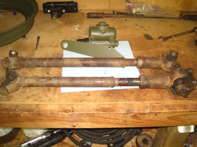

Next up is finishing off the brake system. Then it is on to the propeller shafts. The rear shaft seems okay, but the front shaft is stuck. Looks like I will be figuring out how they come apart. After that, which, I don't think I can put it off any longer, is the rebuilding of the transmission and transfer case...myself. This will really be a learning experience for me.

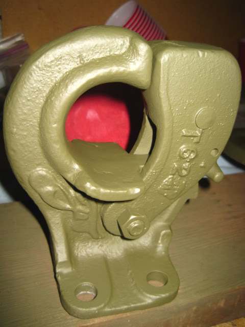

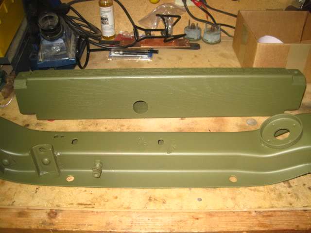

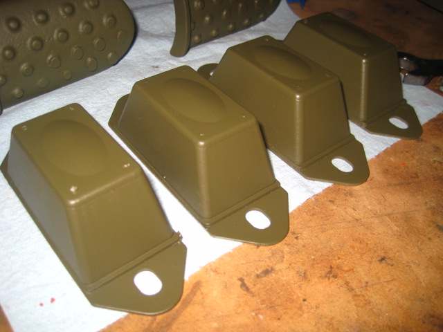

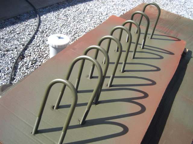

Almost forgot to paint my axle bumpers:

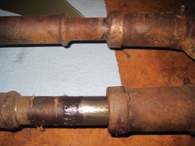

Here are the propeller shafts. The top one is the front shaft that appears to be stuck at this point:

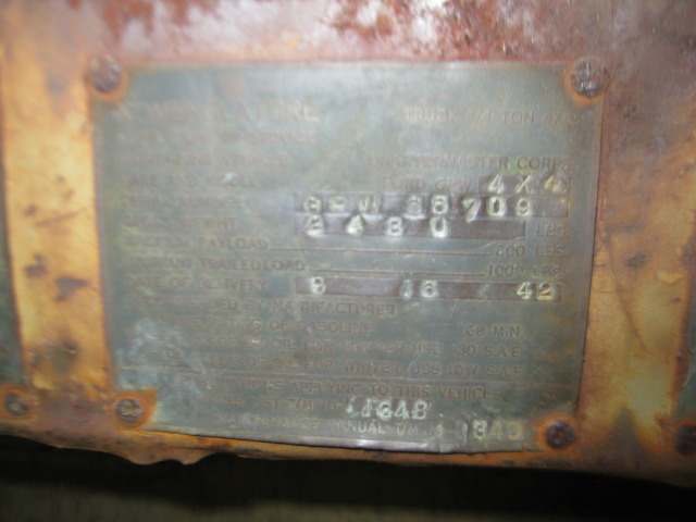

I'm still in the process of acquiring it, but I think I'm going to go take some pics of it tomorrow. I'm buying it from a coworker who intended on restoring it and then found an easier MB to do instead. I'm under no illusions that it's going to take a heck of a lot of effort, time, money, blood, sweat and tears to get fully restored, but it's something I've always wanted. I'm looking at it as a project for me and my boys to do over time (my older is 3 and younger is 11 months!) and it'll be great to finish together.
It does have original data plates and I'll get pics of them when I photograph everything. My buddy purchased it from the guy who bought it as surplus in 1946 and there's an extensive scrapbook with original paperwork, etc on it. The hood numbers are still somewhat visible and it looks like the original bumper codes may still be there as well!

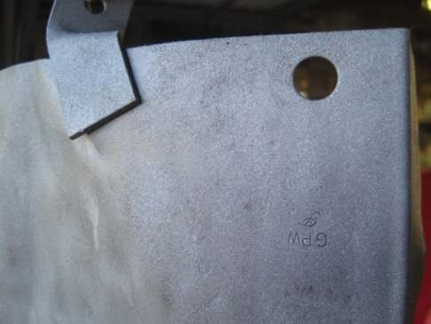

Here's the data plate on mine. Just went and saw her today. She's complete, but in need of a complete restoration. Tub, data plate, frame and block all match. Delivered on 16 September 1942.
Jon, it looks great. As you know, having most of the original parts will be a huge plus as you work your way through the restoration. Good luck and keep us updated.
