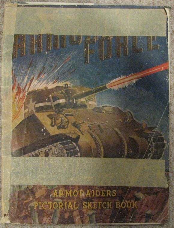

Here is a picture of the masking tape debacle. I'll see if I can gently remove it with the methods everyone has recommended. This item has more sentimental value than anything else so I really just want to get it to a point where it can be displayed. In it's current state I'm not willing to put it out.
Click to view attachment
Thanks for all of the assistance.
TLHSS, I would be interested in seeing some repaired items, thanks.
Ouch - that looks real bad, across the front like that.
Bluehawk
QUOTE(MFortney @ Aug 3 2009, 08:22 PM) *
That, is a paper cover if I am seeing it correctly.
I would not touch it with anything.
It is possible to have the tape professionally removed.
MFortney
The cover is paper. It's slightly thicker than the following pages and has a gloss to it but it does seem rather fragile.

Bluehawk
QUOTE(MFortney @ Aug 3 2009, 10:02 PM) *
I'm so glad you showed the photo.
Scraping or using moisture on that thing would just destroy it without being done professionally.
Be prepared, if/when that tape does get off of there, for there to be darker areas where it once was - since it had been shielded from fading longer... not that it will matter, it'll sure look much better.
