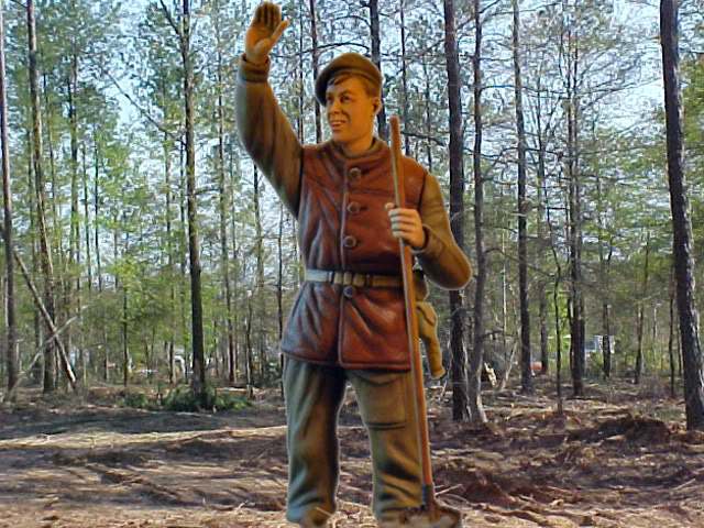

SGM (ret.) Posted October 11, 2009 #3 Posted October 11, 2009 Here's what works for me: Start with an undercoat of any acrylic color (you could also undercoat with enamals, but you need to allow through drying time for them) that is close and a shade lighter that what you're going for at the end. Then for OD and khaki- Ivory Black and Yellow Ochre oil paints with a smidge of various Raw or Burnt umbers will create any shade of OD and khaki (by adding bit of white). Add a touch of blue, red, white, or Payne's gray to vary the tint to the specifc color you want. Oils are the easiest and most flexible paints, IMO, to use for figures. However, you cannot argue with the results that some of the masters get with layering filters of thinned acrylics. As for myself, I find that method just too tedious and time consuming. But the results can be spectacular. Oils over acrylic undercoats will get you 95%+ the results in 1/3 the time, though, and if you're willing to put in the time with oils, the results can be just as good as any other technique. Another advantage of oils is that with only 8-10 different colors in the tube, you can create just about any other color (to include all the flesh tones). This makes oils an economical way to paint, as well. Have you tried asking on any of the military model building forums? If not, try: Track-Link Missing-lynx There are also a ton of figure modeling web sites that often have detailed step-by-step articles on various painting techniques. Develope a good technique that works for you rather than worrying about exact color matches in the jar. Once you have a technique that works for you, you'll be able to handle any color issues. Here are a couple of figures that I painted using the above method. The brownish khaki and light khaki are just variations on the same oil paints. (Mods: I know this is a US forum, and these guys are a Canadian sapper and armored car crewman, but please endulge me this one exception to the rule to illustrate the point. The armored car is a US built Staghound!) Fell free to PM me or ask any other questions here.

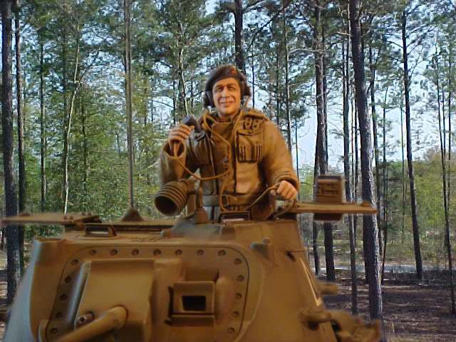

SGM (ret.) Posted October 11, 2009 #4 Posted October 11, 2009 Oops, the file sizes were too large for both snaps. Here's the Staghound commander. Also painted in oils over acrlyics. I usually airbrush the large acrylic areas over a primer coat. This included on these two figures, the uniform areas and faces and hands (with a little simple masking). I brush painted the undercoats for the detail uniform items, then layered the oils over them starting with the faces and hands, then the large uniform areas, followed by the smaller uniform items and lastly the insignia.
