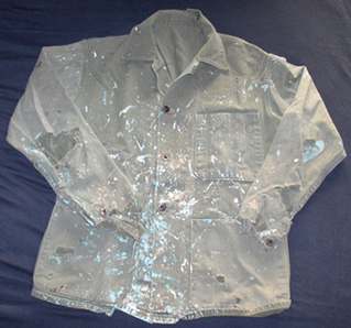

Peace Posted September 30, 2009 #7 Posted September 30, 2009 If someone comes up with a solution, I have a great candidate for restoration. This comes from the estate of Bob Perdzock, Iwo Jima veteran. If you do a search on his name, I have the hole story in another post. This perticular USMC HBT jacket was used by Bob to paint his house. Its named, but no UNIS markings. here it is;
Bob Hudson Posted September 30, 2009 #8 Posted September 30, 2009 I have a paint remer machine at my work . Okay, what is that? I use a Dremel tool on slow speed with brass brushes on some fabrics and if handled carefully can it do wonders.
fortworthgal Posted October 22, 2009 #9 Posted October 22, 2009 I had an old M41 jacket that was literally covered in white paint. It was at least equivalent with the photo you posted, Peace - it might have actually had more paint! It was pretty bad and I remember when I saw it I was mad at my husband for dropping $2 on it. We removed probably 95% of it over several days by alternating methods - scrubbing each individual spot *lightly* with a stiff-bristled brush, then scraping and picking at it with tweezers, and machine washing the jacket. The jacket was a beater anyway so I didn't feel bad washing it 5-6 times. I have also heard that hairspray and Purell hand sanitizer are great for removing paint. Here are some more tips: http://www.goodhousekeeping.com/home/stain...int-latex-may07
