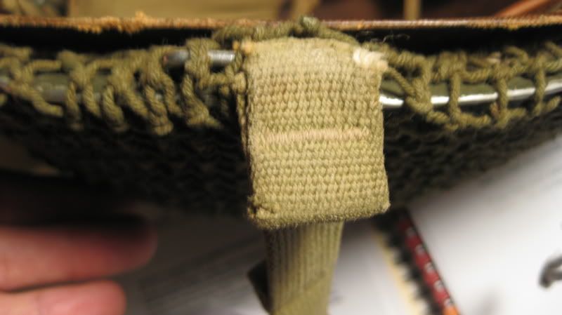

For my fix bail shell I got some repro straps from J Murray, it has a repro USMC cover and liner strap in it so I didn't age it, brought it to the tailor and they put it on, the tack was only slightly far away from the middle and that's because the machine couldn't go that close.
