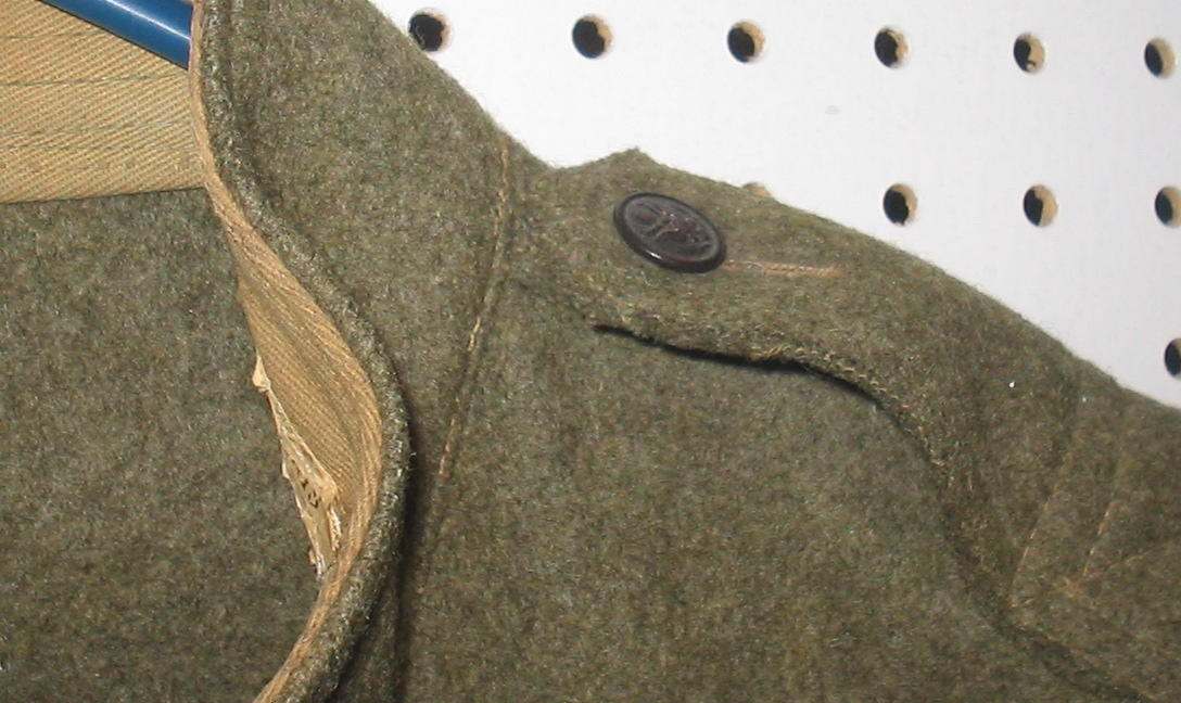

Here is the Spec 1125 wool coat as adopted in 1911. This one has the earlier rimless buttons, though #2 is a replacement and is rimmed. Note the double line of stitching on the cuff.

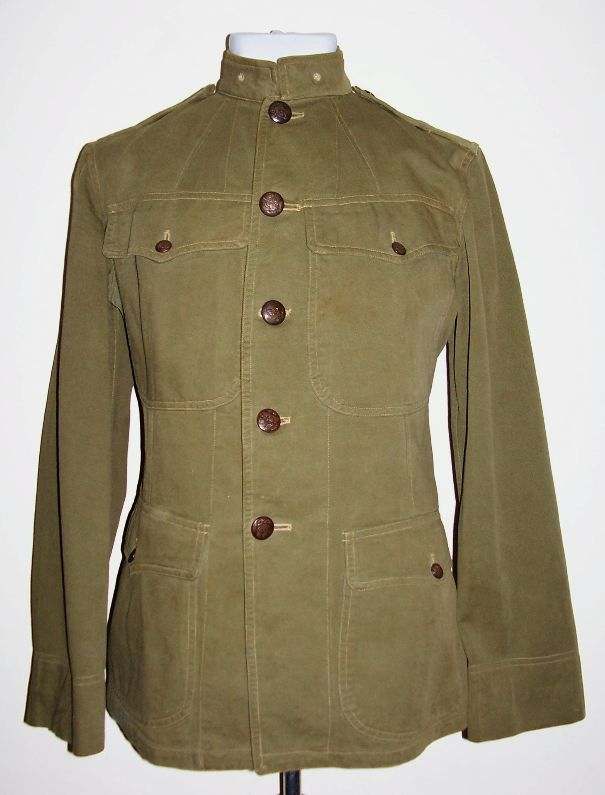

Here's a Spec 1126 drab cotton service coat, as adopted in 1911. Note it also has rimless buttons. The collar closeup shows the inside of the material is "thread-dyed" -- in other words, the threads were dyed (green and brown) before weaving, rather than being "piece dyed." "Thread-dyed" material typically has a grayish cast on the outside.

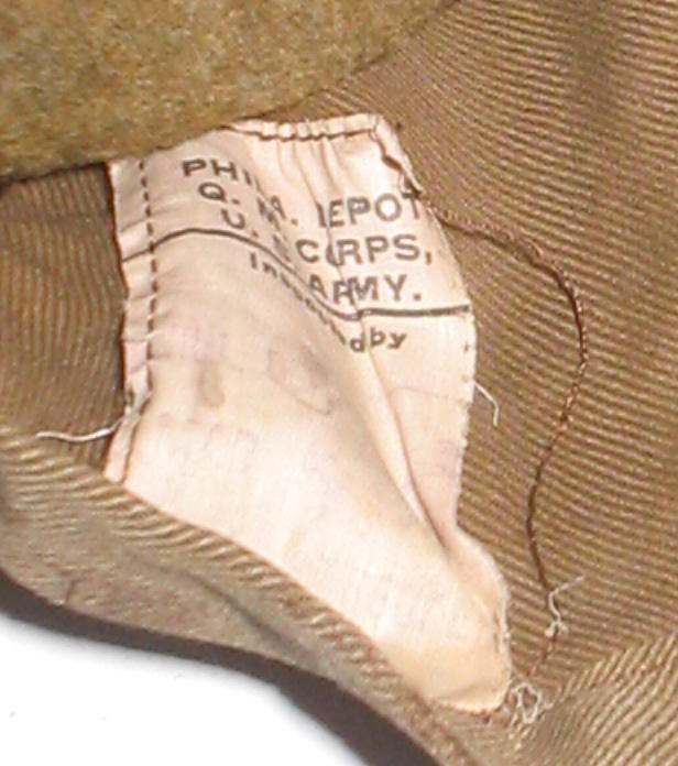

And, finally, is a shot of a typical pre-war QM tag as found in the lining, just to the right of the front opening.

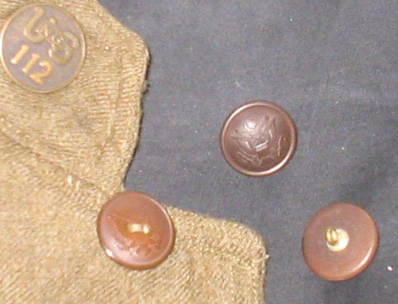

2. Two coats, one in my collection and another known to me, both of which have vegetable ivory buttons with two holes through which to be sewn to the coat. "America's Munitions, 1917-1918" states that a vegetable ivory button, with a shank of metal was used to conserve brass and bronze. However, since the buttons noted were of the sew-through rather than shanked type, they may be either an attempt to conserve even more metal or a temporary stop-gap until the shanked button could be developed.
The example cited above in my collection has another interesting difference too. The lining is black cotton rather than the common olive drab. In all likelihood the contractor could not obtain olive drab and substituted black. The contractors tag is attached to the black lining, so it is not a tailor-made replacement lining.
Another AAMUC member and militaria dealer, when shown the above coat, commented that non-standard linings are not all that uncommon. He’d encountered them in other colors and with woven patterns, even stripes. Whether these still had contractor’s tags still in place, he could not be sure. Possibly these were tailor-made replacements.
Link to comment
Here is a detail shot of the 1268/1285 cuff stitching and a shot of both types of vegetable ivory buttons and the black lining mentioned above.

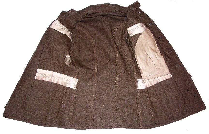

BRITISH MADE U.S. COATS
Two patterns of olive drab wool coats were made in Britain for the A.E.F.

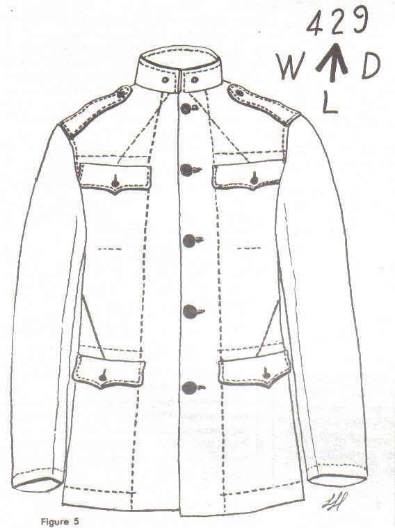

These were outwardly similar to both the M1917 and Ml918 coats but with several significant differences. Both are unlined except for the
collar and facings inside both sides of the front. One has outside patch pockets like the M1917 (see photos following – thanx to Frankie S.–“Morals & Decadence”) while the other has them made of cotton and set inside, like the M1918 (see figure 4). A strip of white cotton is sewn behind the top edge of the pocket flaps, and this shows from the outside too, on both versions. The pocket bottoms of the inside pocket version are tacked to the wool body and this line of stitching is visible on the outside also. The pocket flaps on the inside pocket coats are set in to the pocket opening rather than being sewn to the outside as on American made coats. The only marking in the British-made inside-pocket coat in my collection is
429/W Broad Arrow D/L which I assume to be a code for the contrac-
tor or contract. It is undated.
Link to comment
It seems to me that some serious research should be done into this pattern. It would be interesting to know if the British pattern is the ancestor of the Ml918 or how closely their design is related to late-war coats made for British troops. I suspect that only the collar may be different. Even so, if the British Army's late coats used the concealed pockets, it may be that General Pershing (or his staff) may not have been as creative in the design as he (they) have been credited. I suspect that British sources should be researched on this subject for best results.
