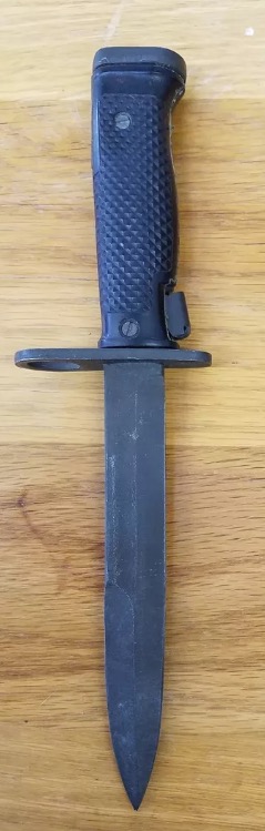

I have been looking for a M6 and ended up getting this one for $20. It hasn't arrived yet, but wanted to get some opinions. Thanks!
Link to comment
First off, for $20 you can't go wrong. This Milpar looks good to me. The fact that is does not seem to have a DAS mark ,that I can see, does not rule it out as being a US contract bayonet. Especially if it is a later 1960s version, which this might be. The DAS was being phased out during the sixties. The other thing is the back cut of the blade. It is not a sharp 90°, but one side qualifies as a near 90°. I would tend to think this M6 is legit. Newly made M5A1 bayonets were sent all over the world to aid countries who had millions of M1 rifles and tended to have curved back cuts on the blades. I doubt (but I could be wrong) that many M6 bayonets were manufactured specifically for aid programs, simply because there were not the numbers of M14s in other countries to warrant it. I would say your bayonet is US issue, even if it doesn't conform to all the specs.
As always, please correct me if you have better information.
Marv
Link to comment
Does it have a DAS mark?
I will check closer when I get it in hand, but I don't think it does. It could be a late 1960s contract piece. Thanks for the comments!
Link to comment
MattS- Marv is right! For $20 you got a fantastic buy for what appears to be a mint, Mil Par M6. If it has the DAS, that's a plus, but not a detractor if it doesn't. Thanks for showing. SKIP

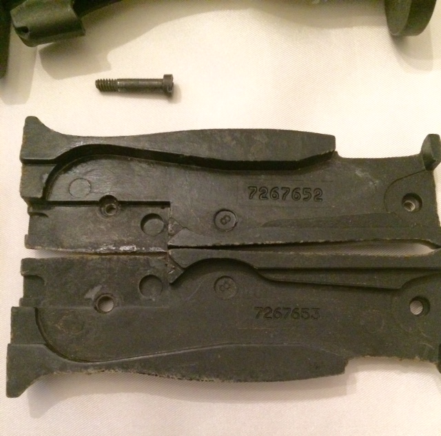

The only thing I'd say different from what's been said already, is when you get them you should take the grips off and examine how they look underneath. Recently I'm seeing bayonets coming in that at first glance look good from the outside.
The prices are typically lower than market from what they appear to be. Much lower.
The part that really bothers me is that the guard markings, at least from the pictures, seem like what I'd expect to see.
I don't know yet, but I'm worried that our hobby has just gotten a little more complicated.
Link to comment
Thanks for that! What should I be looking for under the grips? Can someone post photos of a textbook example with grips removed for reference?

Correct Government issue grips on the left and the after market Eickhorn on the right. Notice the threaded inserts molded into the handle. Also the Eickhorn grips won't fit a genuine G.I. M5 or M6.

I can't get the grip panels to separate on mine, but I can tell you the screws are different than the ones on mine. Mine has all thread and yours is straight shank with thread only at the bottom. Hmm. Hopefully someone will know what that means.
