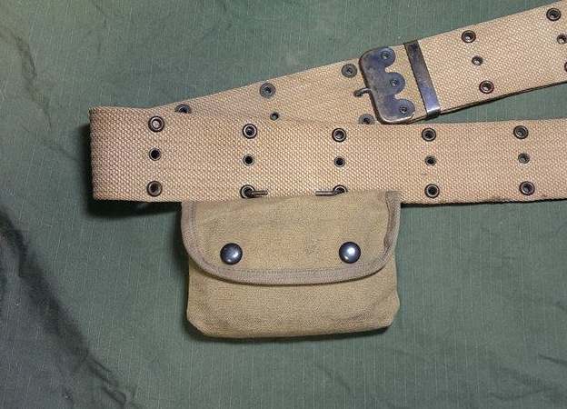

Well, here are photo of 2 of my USMC FAP ... others are on mannequin, and all type II, identical to the one I shot.
Both are identified, the type III was found with a very nice M1912 belt, USMC marked and also id'd to the same Marine.
Detailed photo of the type II :
... and type III :
Regards, E

Hi etienne,
I'm happy to say the examples you posted are 100% textbook original. The buttons, stitching, thread, and wear make your pouches in my opinion great USMC items :)
Thanks for sharing.
