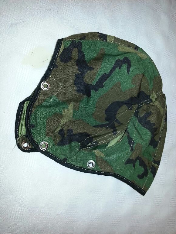

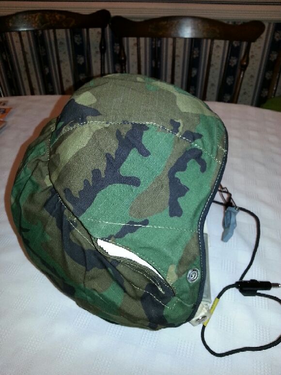

Raising this from the dead. I have a USAF HGU-26 helmet that I just recently cleaned up. It came with a custom woodland camo cover specifically for the 26/P style dual visor housing. One would probably first think it was a USMC thing but anytime I've seen a helmet cover or the helmet already setup for one the Marines seem to always glue 1 half of the velcro in numerous spots around the helmet along the edge roll and visor housing area. The cover that came with this helmet has 6 grommets which allow it to be installed on the helmet using the nape strap screws, chin straps screws and the lower LH and RH side visor housing screws. I cant say I've seen another cover like this.
http://i1100.photobucket.com/albums/g419/mohawkALSE/A-6.jpg
http://i1100.photobucket.com/albums/g419/mohawkALSE/E-4.jpg
http://i1100.photobucket.com/albums/g419/mohawkALSE/F-2.jpg
When I got the helmet it originally had the cover on, and also had a standard single plug headset cable which would lead me to believe this might have been a helmet used by a USAF FAC guy having the boom as a primary mic but the ability to mount a O2 mask. Could also have been potentially used by a USAF rotary wing crew member. The comm items were early 80s dated. I restored the inside as the original soft ear cups were destroyed from age, and then I changed it to a dual Boom/Mask ICS cable. I wanted to have it setup how some US Army OV-1 Mohawk crew members had in the 1980s

Interesting helmet and fun research project. You can probably rule out USMC. I don't think they used the HGU-26 and, if they did, likely would have had a production quality camo to go with it. Along those lines, I'd look into when the USMC cloth covers started being used. I suspect a case of "cover envy" by your helmet's original user!
The visor housing has been cut back to allow better upward vision. This was a popular modification within the fighter community. I suspect this mod wasn't bothered with by the bomber and transport folks (then FB-111 excluded).
Not sure about FAC use. Other than the O-2 Bird Dog, I think everything else used for FAC work would have used helmets with masks. I'm not sure about USAF helo helmets. I'm sure they used the boom mic setup but I would have presumed they wore camo-taped helmets like TAC aircrew.

The HGU-26/P helmet with camouflage cover could also be from a USAF loadmaster such as C-130 aircraft.
I have also seen Army OV-1 pilots wearing HGU-26/P helmets. Flightsuits Ltd. (now Gibson & Barnes)
did sell single and dual visor helmet camouflage covers with the grommets at one time. The helmet
covers were originally secured with grommets through the chin strap screws. I believe it was during
the late 1980s when the USN/USMC started securing the covers with velcro so that the cover would blow
off during ejection/bailout so that the reflective tape underneath would be visible for search crews
to spot the aviator(s). I have also seen video from Desert Storm of an A-7E Corsair II pilot wearing
a helmet that was painted desert tan over the reflective tape instead of using a camouflage cover.

Looking at the cover, I'm wondering what the slits in the sides are for? Does your HGU-26 have the strings coming out the sides which pull the earcups back?

I think those slits in the cover are used for sliding either the tinted or clear lens down and up.

The slits in the side of the cover are for the dual visor actuating levers.
This helmet doesn't have the older style hard ear cups with strings and velcro. It came with custom white leather "elephant ear" soft ear cups. Those were destroyed from age so I replaced those with some grey ones I had in a spare parts box. I've never seen the white leather ear cups, only grey or black. Other weird thing is the custom molded liner is also white which I've never seen. On older helmets its usually a black or dark brown and newer ones had grey.
Its very possible the helmet cover was bought from Flight Suits many years ago if they did sell them. It seems like a limited production item vs a rigger made piece. There is also a small white tag sewn inside it with an L for large, no other markings.
Obviously I have no proof of who used it but if I was to take a guess Id say a USAF O-2A or OV-10 Bronco pilot perhaps.
