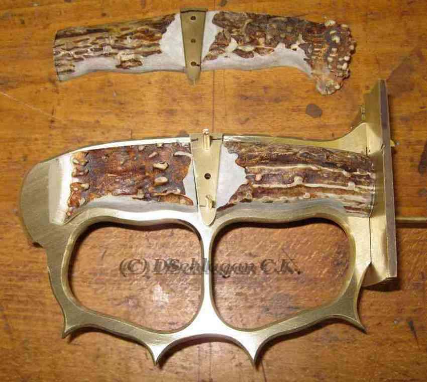

Here is some progress from today.
The "split-grip" is now more apparent.
The left side brass spacer is blending pretty well into the bench, between the left side grips. It has had the two main edges profiled.
The reason for leaving all that "extra" brass at the pommel should now becoming more clear.
I believe that keeping the "crown" portion of the antler, intact as possible, really adds a lot of beauty.
For that matter, I limit machining to keep the entire antler as naturally appearing as can be.

The front right grip panel has been fitted, profiled, and contoured. The front left (photo top left) has also been. The right rear has just been end-cut fitted.
That brass spacer is by no means just decorative. It will serve to add much strength to the finished assembly.
Ricasso guard drilled for pinning. It must be drilled prior to fixing blade; no way to do it after.
This project is in some ways like a jigsaw puzzle; it requires placing the pieces in a very specific arrangement, while maintaining a very attentive order as to progression.

Here is today's photo journal:
It is beginning to take, more towards, finished form. Lots of detail to still tend to...
All grip panels have been rough profiled/contoured. Will work through several progressive grits of sanding, then three grades of buffing.
Another neat aspect of using shedd antlers is that the extreme base is there to work with, as well as the "crown". That base will buff out like glass, and has attributes/appearance very similar to ivory.
A great place for a little scrimshaw?! :think: ;)

Still contemplating exact final design of ricasso guard.
Haven't decided whether I prefer the saturation effect of the flash, or the more subdued of, without.
They both have their positive aspects.
[I did notice that the photos taken with active flash have considerable more data in them, than those without.]
Note the structural significance of the pinned brass spacer, as well as aesthetics.
That center pin will go right through the tang.

I spent considerable time adjusting the angles of the 'rear grips to brass spacer', in the desire to maximize resulting "crown".
Later (top view) photos will show that the area at pommel (original crown's "bases") to be lined up, as close to original, as they were before splitting.
I employed a similar modified skull-cracker pommel, as I have designed/built for other "crown stag" handled knives.
